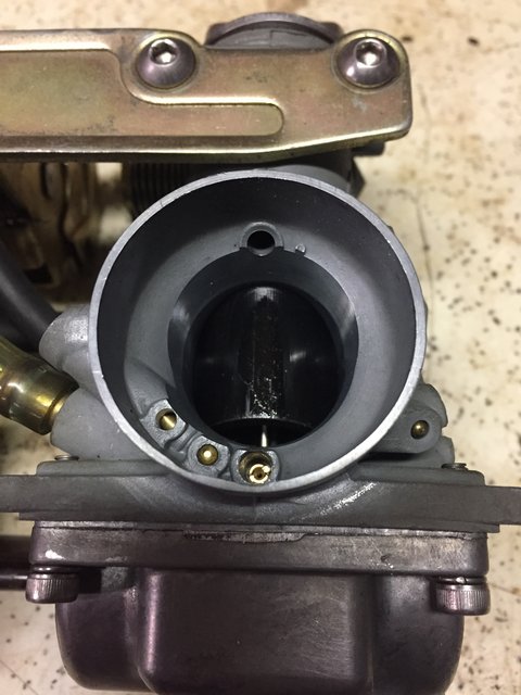

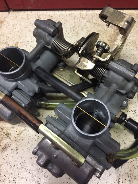

Brought these home from Portland last week, where I was able to visit Mr. Ron Black:
OEM RZ350 carburetors taper-bored to 29mm (I think I mistakenly said 30mm elsewhere) with divider plates installed and supposedly jetted to suit. Anxious to try them on Ol Faithful.

That being said, these carbs I brought home have dividers only on the engine side.  Here's a little more from the man who did the mod:
https://www.rb-designs.com/rb_designs_llc_004.htm

John Ritter advised me to get my carbs modded with the divider plates. He was quite certain it would improve low speed performance on my R5.
RB modded my TDR carbs at least 10 years ago.
He bored them to 29.5mm and added his engine side divider plates.
Tough to say what difference it made as we did a lot of other stuff at that time also.

if it's not too stupid a question, what do the dividers actually do?  :Clown:
cheers, gil.

From what I understand they create separate "air intake channels" that reduces turbulence and increase flow speed mainly to low speed circuits.

Basically they make the carbs act like they're a smaller diameter than actual size until the slide gets opened above the dividers, similar to how a 2/4 barrel carb works on a car
