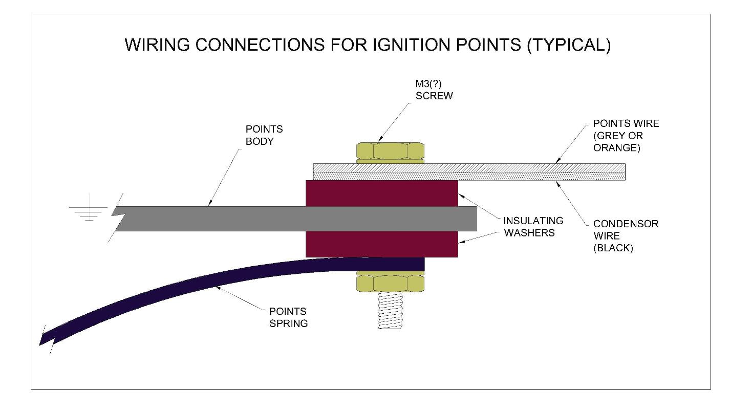

make sure the wring at the points is isolated correctly as well. like this:
also make sure the gap is set to .3-.4mm.

CHARGE YOUR BATTERY AS WELL, and look at condition of all wires and connectors related.  I chased a bad points-to-coil wire on my T500 for a few weeks, and it was intermittent.  repaired it, then put on a cdi anyway. lol.
Milan
Looks like it was a bad condenser.
Swaped leads & got spark.
Put RD250 one on, & both spark.
Must have had a short to ground on that side.
( single condeser, dual leads )
