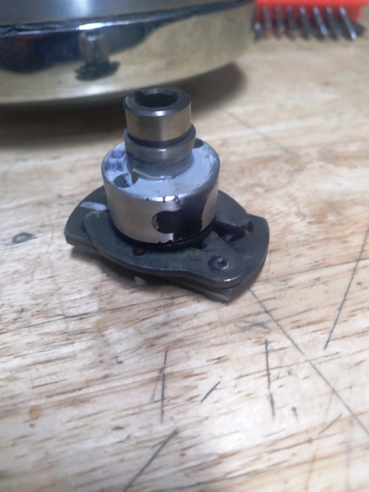

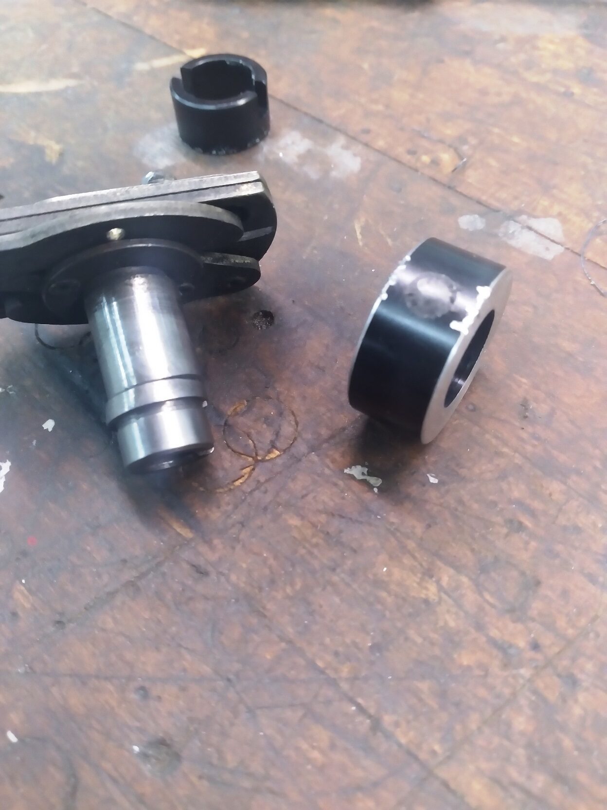

I did NOT want to make it a non-reversible mod, so i had to get creative. modified the ignition trigger, bored it out a hair, milled the non magnet side flat (to accomodate a set screw), and hand cut a pickup plate.  I wanted to keep the elec starting as well.
modified magnet trigger:
mounted, then trued on the lathe since this was going to have the 'low' spot on the magnet side, i had to turn it a bit assembled.
I do know i could have used a sunken set screw to mount it, but wanted an externally accessible screw i used some case sealant in the gap as some 'insurance' it would stay put. I did not mod the points cam, so this can be taken off , wire wheeled and be used for points.

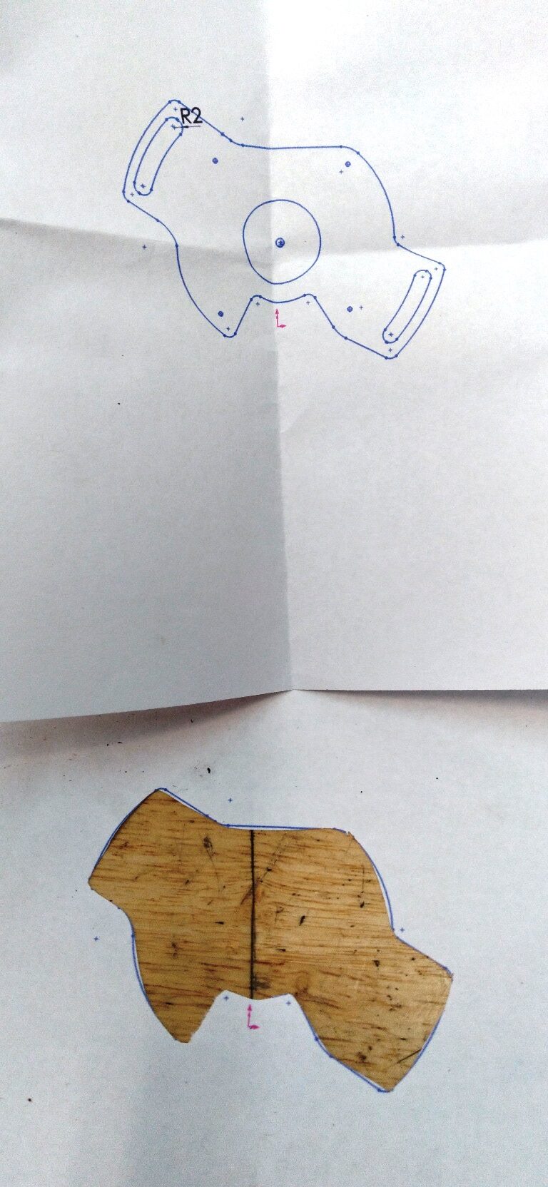

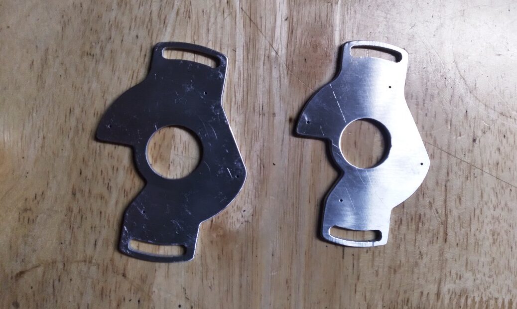

drawn template for pickup mount to bolt on. I have some being laser cut but i got impatient and made one by hand.

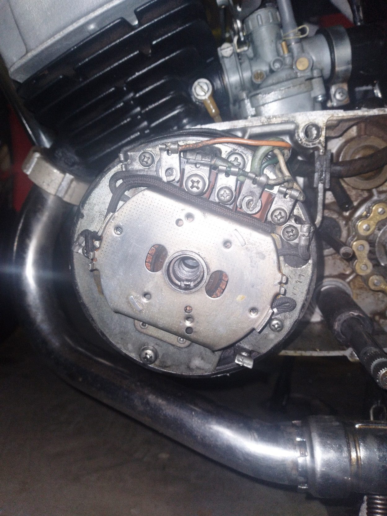

bare points plate:
mounted:

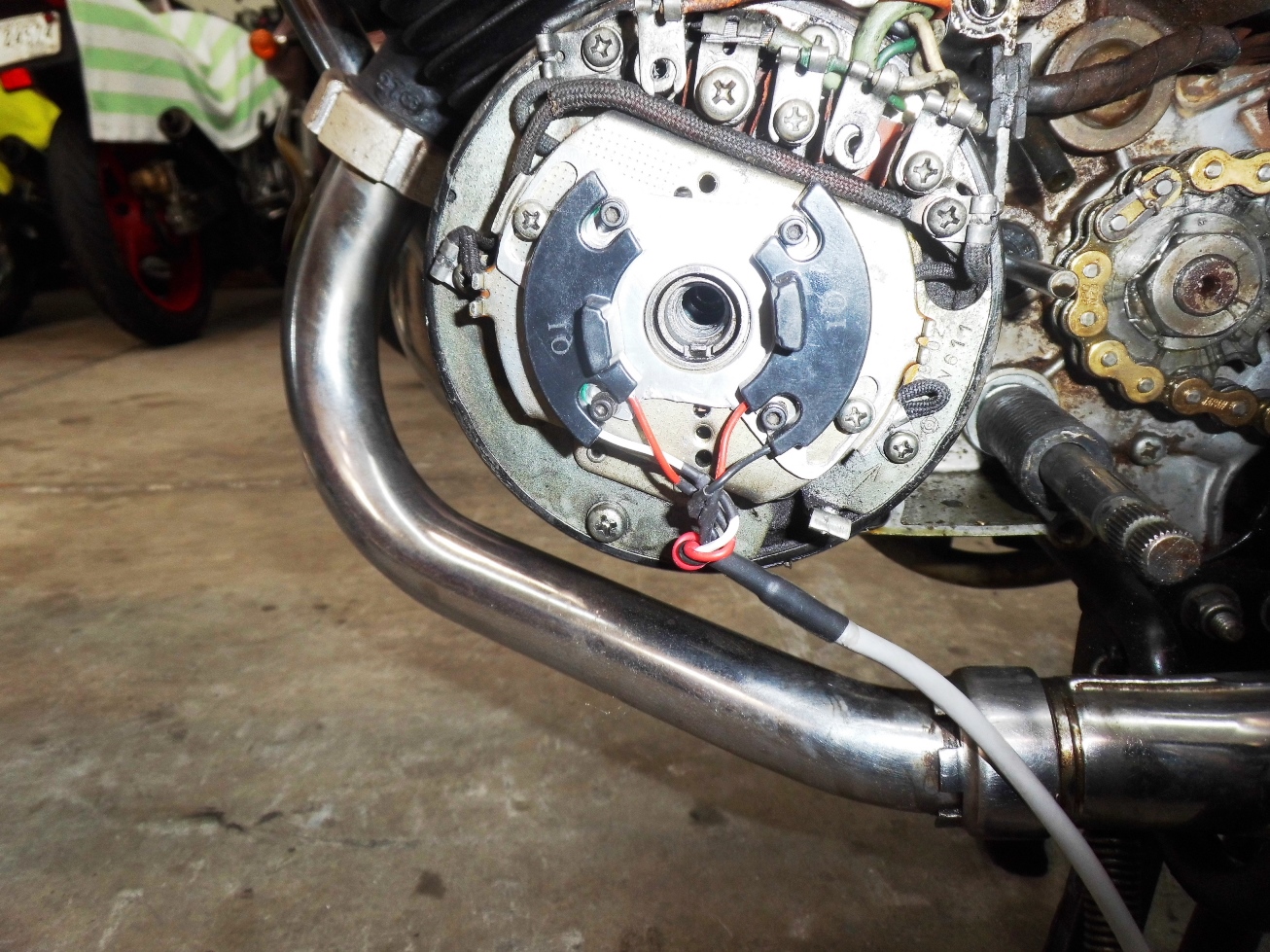

mounted with temp wiring:
running. advance unit is noisy w cover off.

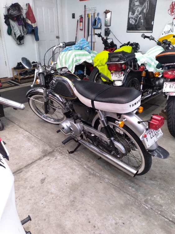

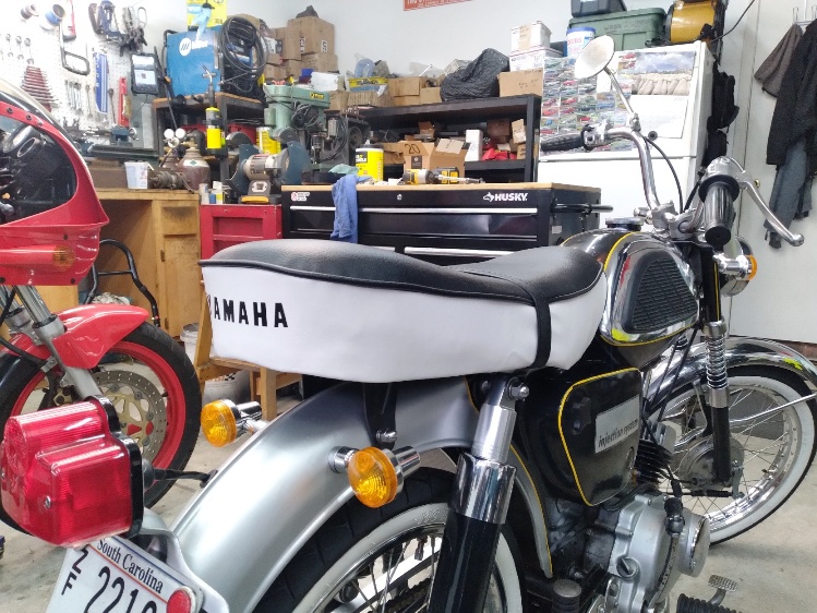

got my seat back for the little YL1E today, was hand made cover/foam and is absolutely accurate to original . Bill did a fantastic job as usual. used a correct reproduction cover , but with thin material, as a guide. the stenciling on th eback was sone with vinyl dye and a die cut template.
Dare is say its done for now.  :celebrate:

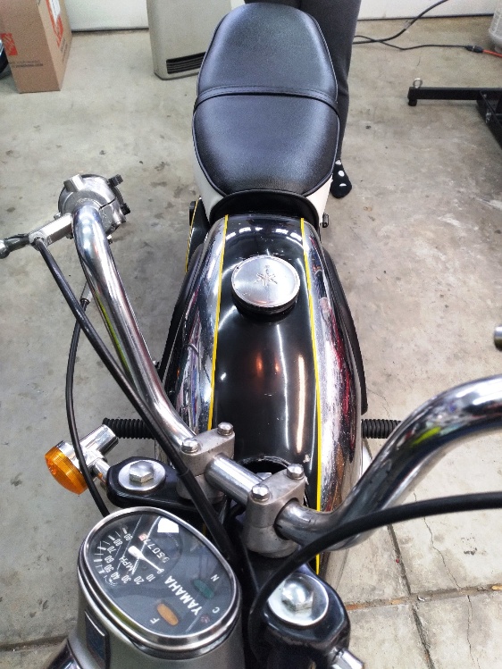

i made the pan repair so it didnt rest dead on the tank on purpose, but i am sure it will settle onto it a bit over time.
