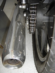

This is the 530 oring on my 400. The clearance issue I had was with the flange on the bolt head of the chain adjuster, rubbed the chain a bit. So I grinded off the flange and works fine. I had no issues with the front sprocket rubbing the cases, but you could run a spacer on the front sprocket up to 2mm without chain alignment issues if you needed to gain some clearance. That chain has hardly worn or stretched at all, lots of adjustment left.
