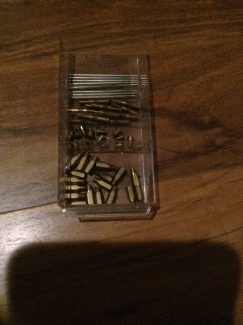

Only can find one 45 pilot, so hit jetsrus.com and ordered one 45, two 48, and a pair of 148 mains.
Plugs are wet, but starting to look the right color at least.
