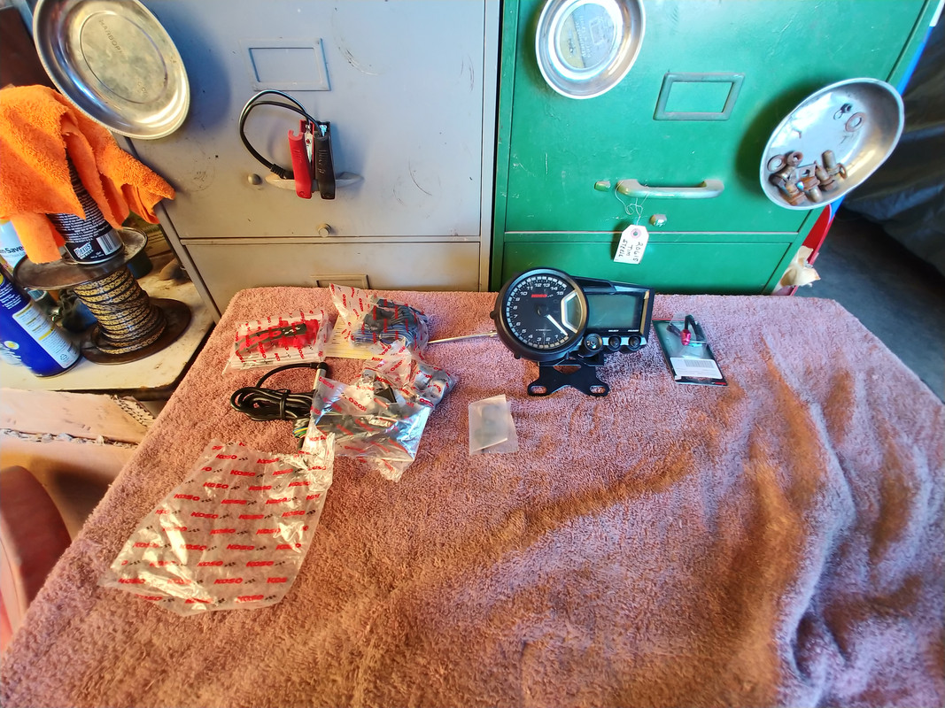

Ordered yesterday. Install process courtesy of Frank B will follow.

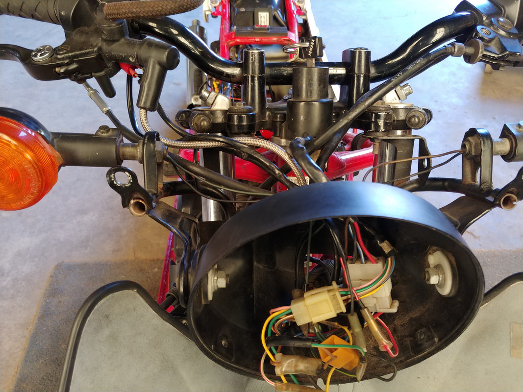

Will do. I found the best deal for the instruments to be Amazon. The 10MM 1.0 water temp sensor was out of stock so I found it on Dennis Kirk. The part number for that is BF100100. We will be cannibalizing the wire harness from my parts instrument cluster so this will all be completely reversible If it ever needed with no modifications to the factory harness.

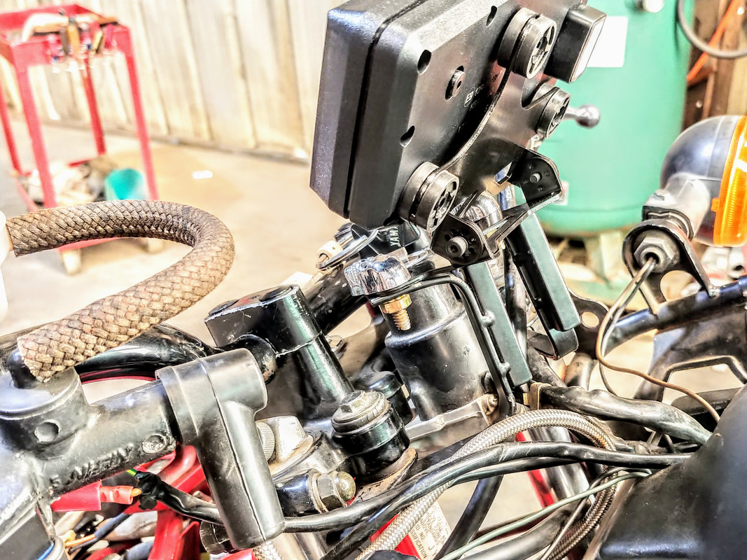

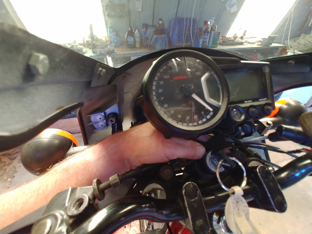

This is approximate orientation. I made two small brackets that will attach to the rubber mounted bolts that hold the birdcage in. More to follow.

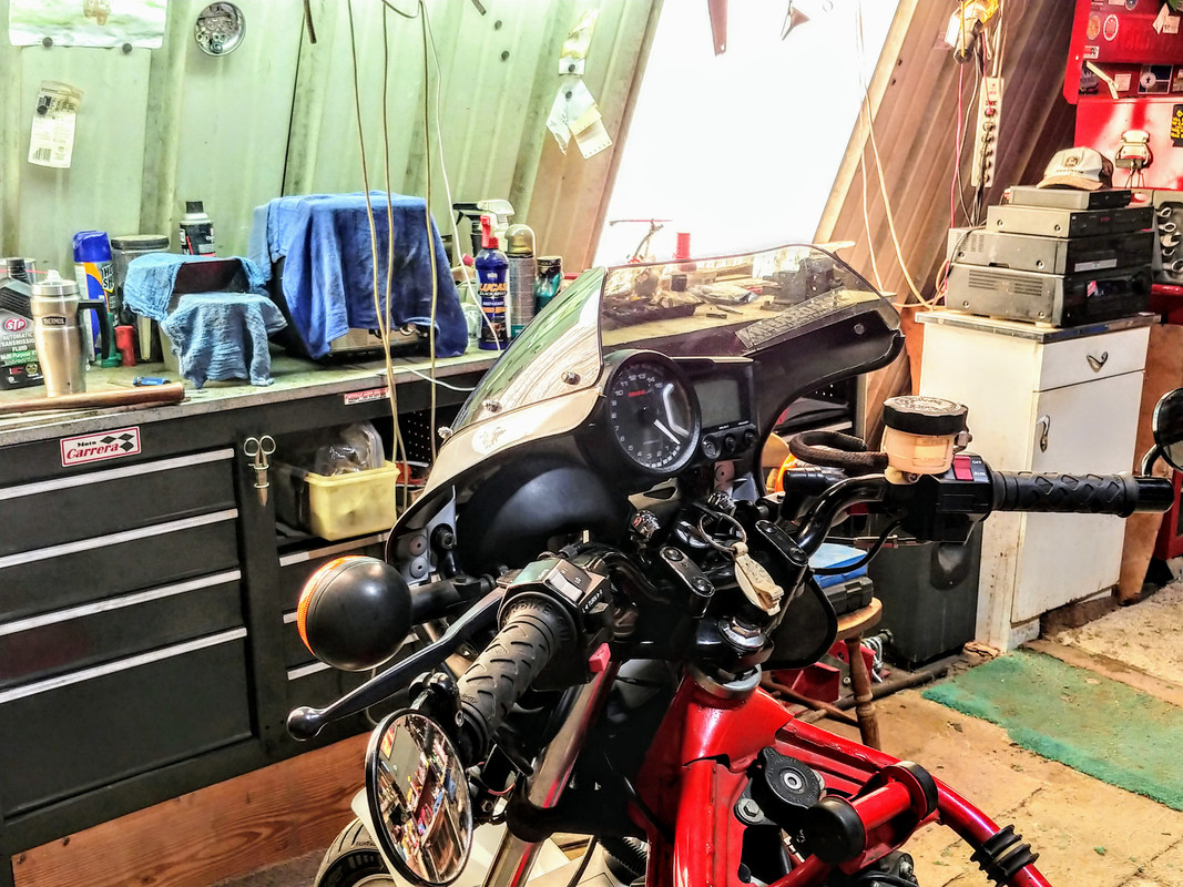

Rear view. Frank B will be coming over tomorrow to help me finish the install. All that is left is wiring, temp, speed sensor instalation and programming.
