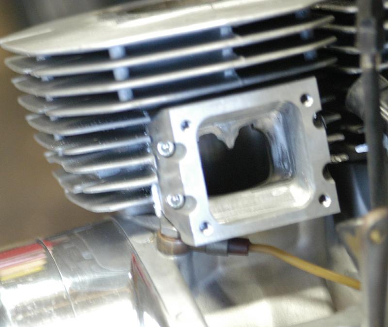

I like that . I love reed conversions . I do alot of them here is a manifold I recently made and produced for early Honda elsinore 125s
racerclam
Here is the prototype installed
racerclam
oops ! that wa the wrong pic , same manifold but on a Hodaka 175 . This pic is on the Honda

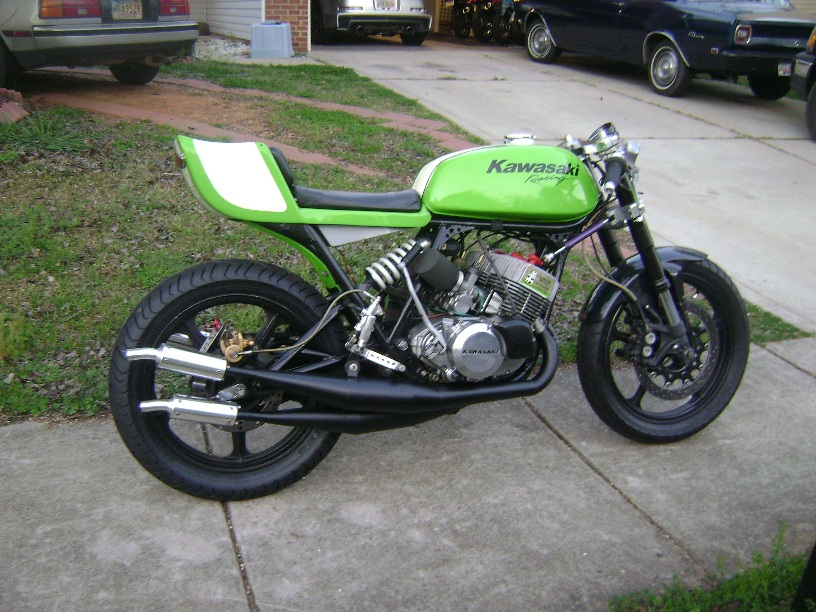

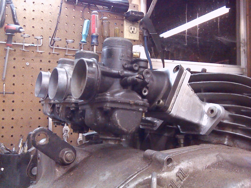

looks similar to ones i did for S series kawis a few years ago:
then the 73 h1 i had. ran 2 boost ports up the back of the cyl :
would up using chariot performance cnc'd banshee cages and PJ34's with one off dencos from Jim Hobbs. Man this bike made/makes gobs of useable power.
reed conversions are good. :metal:

very nice work . I have 4 different manifolds that I have made and produced and apply them to many applications with use of different mounting plates Here is another one

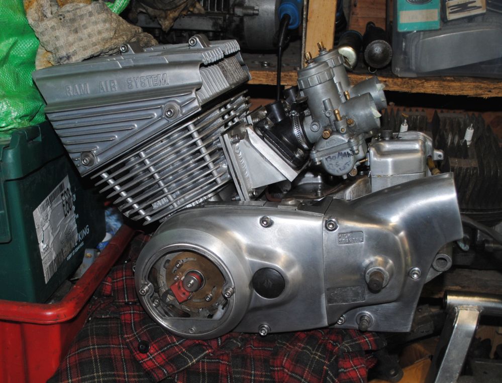

Quote from: Gil Gallad on July 13, 2020, 08:56:29 AM
dead thread revisited  ;D after 7 months this is what i came up with. and this morning it ran properly for the first time. i installed it in an old gt250 frame, wired it up and fitted a temporary fuel tank. all that's left now is everything else. photo is mid build, until i can find the later photo's  8)
cheers, gil.
gt250 ramair reed conversion:
Spectacular :cheerleader:
1975 RD350 (under construction)
That Suzuki engine looks great with reeds!
The H1..  :drool:

heads now off for vapour blasting, but i took this photo before i took them off. boost bottle fitted, but i just guessed the measurements - 180mm long and 24mm i.d. does it make a difference? not got a clue, but it still fires up and runs. think a trip to a dyno might help  ;D
cheers, gil.
boost bottle:
ditch the emgos, at least run all foam ones.
Gil Gallad
hi mate, they were supposed to be here last friday, but i'm doing a diana ross again - i'm still waiting  :evil2: i just put those crappy ones on just to keep anything from going down the carbs. i always use the foam sort now  ;D
cheers, gil.
