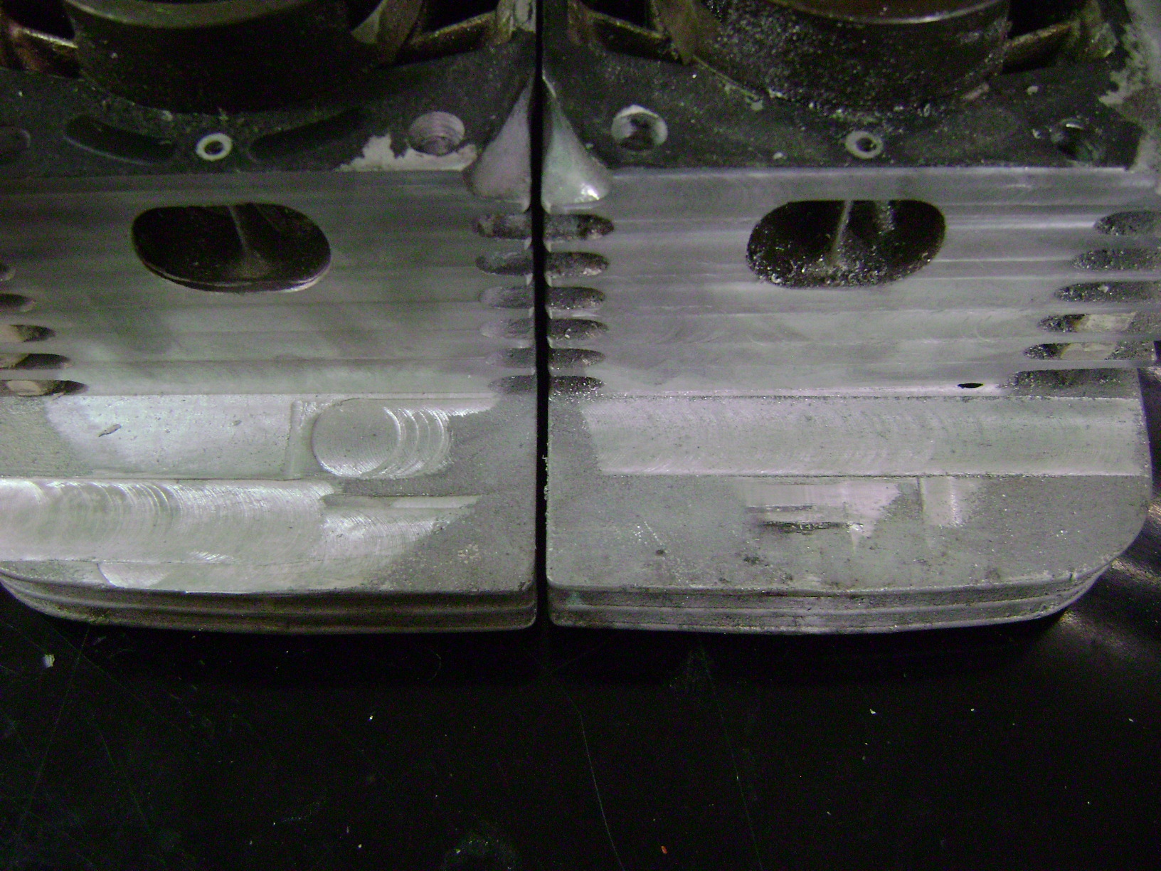

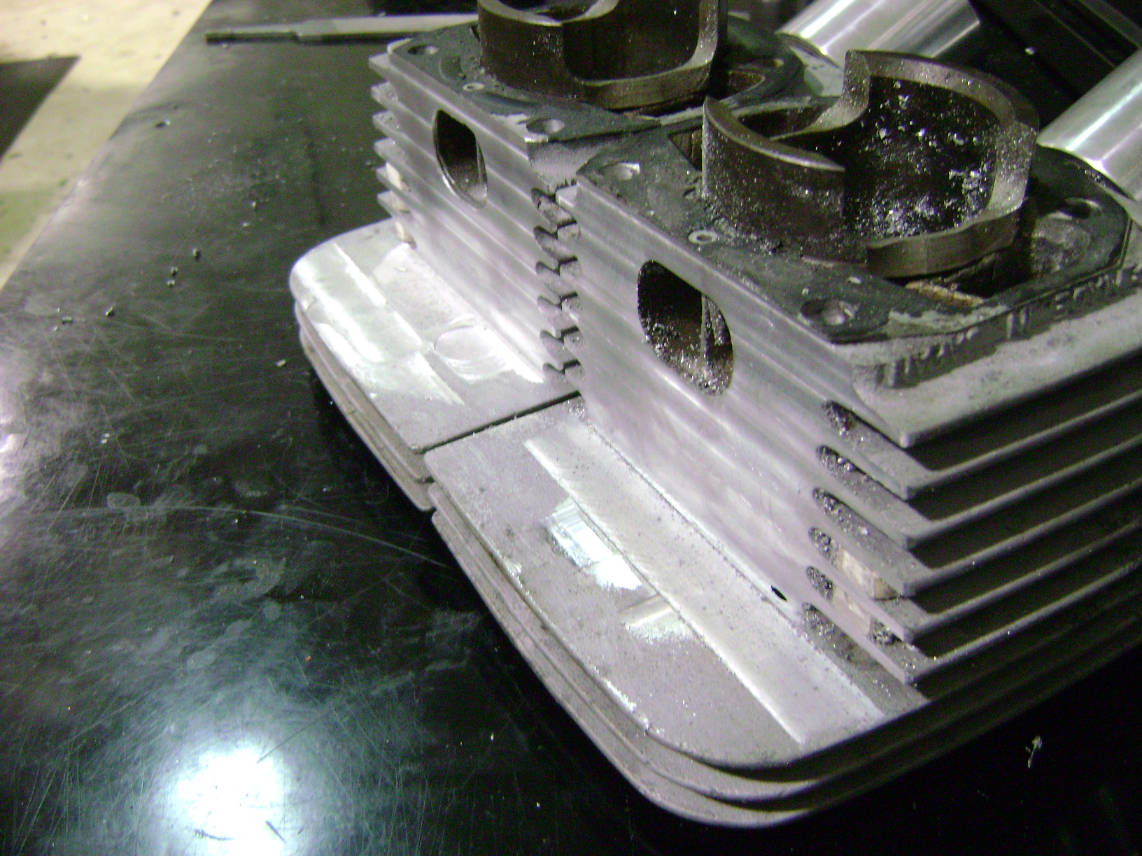

i would, tbh, its easier i think in the long run. I've milled a set of GT250 cyls for reeds for another guy,(Tom Garcia)  he used some 8 petal snowmobiles reeds on it, supposedly worked out great.

i might have pics of me milling the back off them, maybe. i didnt add the reeds, tom did that himself.

any pics would be welcome before i start milling chunks out of a good set of barrels, or even a drawing would help. the only bit that baffles me atm is the gt inlet port, which is standard at 26mm and round, which reall won't be condusive to good flow from the reeds' thanks again for your input  ;D

i only have the 2 pics. i just milled the back flat, he did the porting and addition of reeds. i know he added tranfer ports and opened it up quite a bit.
note the intake oiling hole is still intact.
Here's one I grabbed from Tom's thread way back when

i mean, it only took like 15 minutes per cyl in the bridgeport, wasn't hard to do.
thats cool you have that pic, i lost it a long time ago.  he just told me 'mill it flat' i was like 'ok' and chips went flying.  :science:
