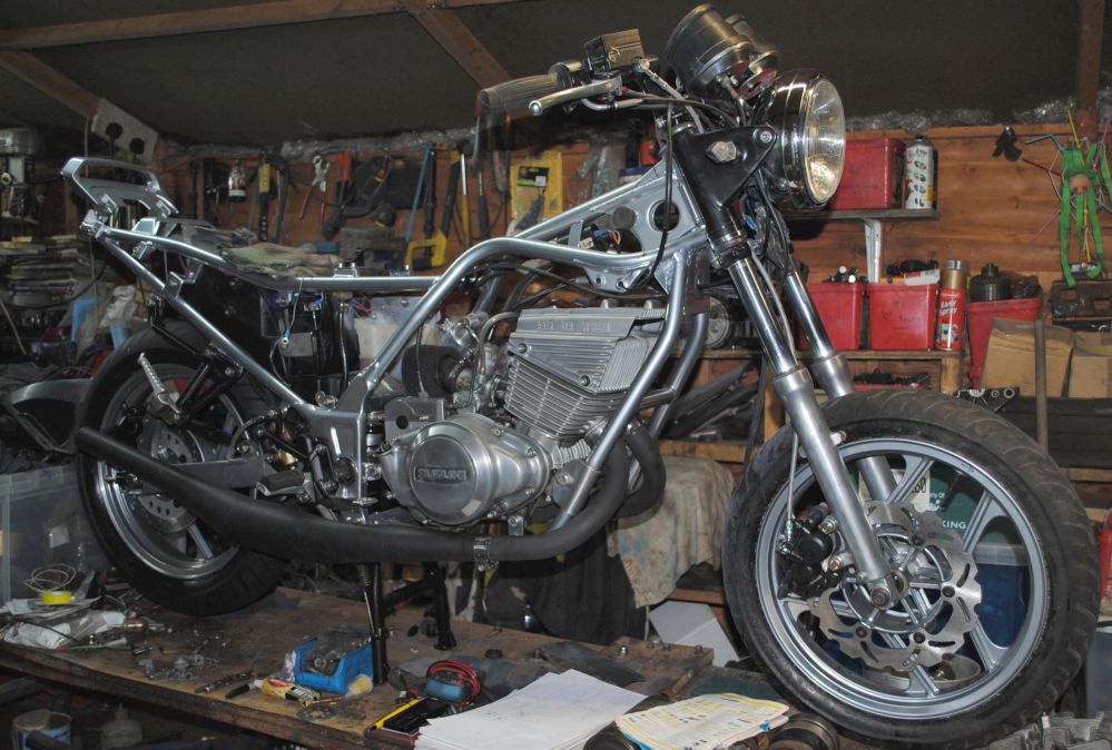

Gil Gallad
how she sits atm. you'll have to look close to find the rear shock and remote, but it's all crammed in there somewhere  ;D don't know whether you can spot it on this photo, but there's a pair of 4mm baseplates fitted - the ts185 pistons were 4mm higher than the gt250 pistons. just waiting on the paintwork and recover the seat  8)
cheers, gil.
how she sits:
Looks fantastic!
Can't wait to see it with the bodywork fitted. :metal:
I'll second that, excellent work Gil. That's going to be a very cool bike very soon!

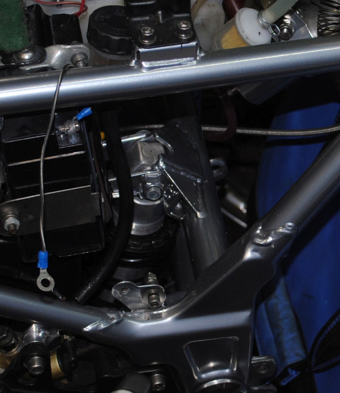

Gil
What triple tree setup is that in the pic? Will you be using the stock ninja tank and body panels? I hate component failure when you are expecting long life from new parts. :umm:
How different is the GSXR400 shock mounts from the ninja?
Gil Gallad
#26
everything is gpx250 [apart from the rd headlamp and gt headlamp ears] and yes, i'm using the stock tank etc. the original one was kaput, so i got another - it cost me more than the rolling chassis  :umm: bottom mount is the same and the top mount i needed to cut some away and weld a piece in. about 10 minutes work that was all. think you'll find the gsx-r shock has 10mm holes in it and the gpx has 12mm, so you'll have to drill them out. don't worry, there's plenty of meat on the ends of the shocks. hmm, thinking back i reckon i just drilled one end and changed one of the bushes for a gpx one  8)
cheers, gil.
not a very good photo, but i took part of the ninja top bracket out and put gusset plates in. there's plenty of strength there:
