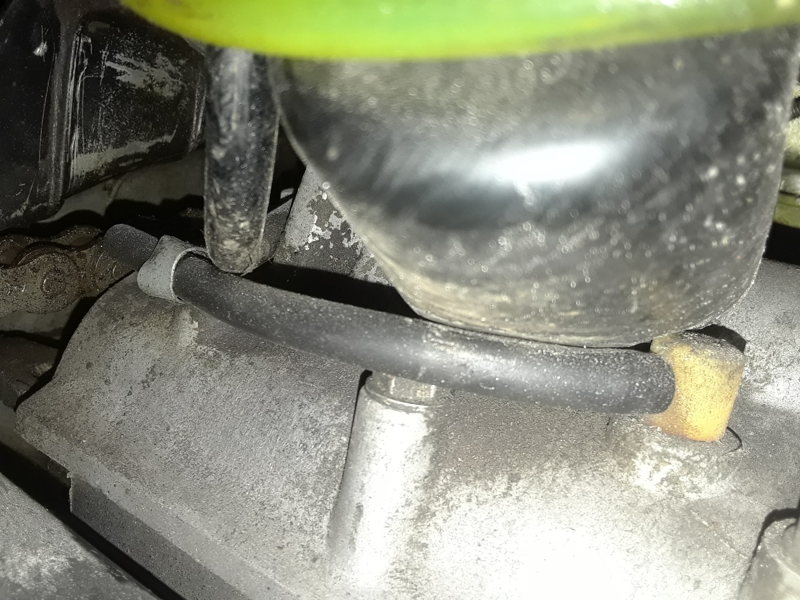

just checked 2 bikes i have here at work in the warehouse.
dead stock, motor never been out of frame 75:
and my lightweight. I need to clean this, yeesh (at least it proves i actually ride it)  :dawg:
no numbers on case on either. prob was done at a shop at some other time? or they quit doing it because it didnt matter? who knows. But ive never seen it on a stock unmolested set of cases. i can check the R5 tonight.  :twocents:
