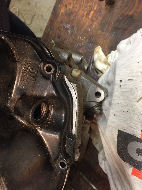

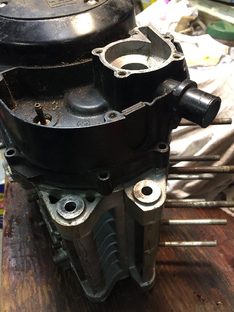

Side covers are a slightly different shape and have a different number of screw depending on the year of your crankcases.  A small amount of Devcon or JB weld in the right places should be enough to seal the side cover gasket.  That leaves two issues - water pipes and pump drive.
You need a longer crank nose and it may be possible to swap in a Banshee crank end for a 54mm crank.
Banshee top ends don't fit RD cases but LC top ends do.  Banshee cranks are wider and require some machining to make them fit.  RZ and Banshee transmissions are wider than RD air cooled and don't fit and Banshee trans has horrible ratios to boot.
The other possibility is adding a water pump to a slight modified R5/RD side cover. I used a TZ water pump on a 6mm adapter plate in place of the oil pump and used an RZ water pump gear IIRC. Those adapters were quite common for Kart racing a few years ago and I got mine with a Kart motor deal some years ago.
For an air cooled motor using a Banshee lock up clutch, it's simpler.  Same JB weld to keep the oil in and a couple of blanks to block the water passages in the cover.

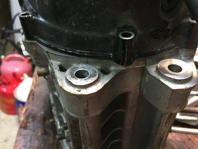

Some RD/TZ cases have a screw mount at the front and some don't.  Some have an untapped boss that needs to be drilled and tapped.  Check the side cover and crankcases to see how well yours match.

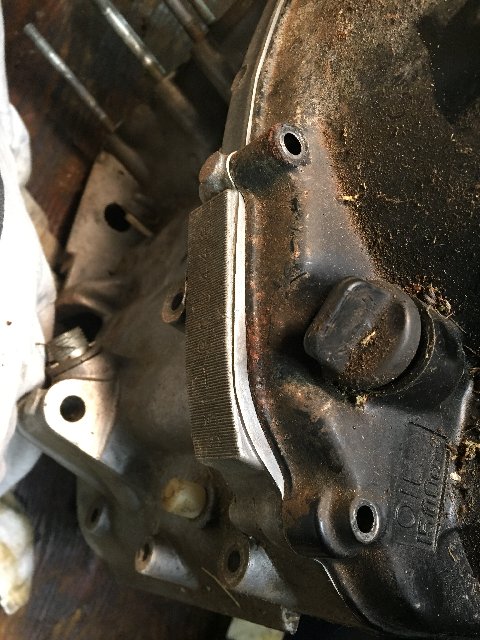

Illustrations for the cover options, Banshee clutch cover on RD350 cases:
LC clutch cover on RD350 cases, basically the same
