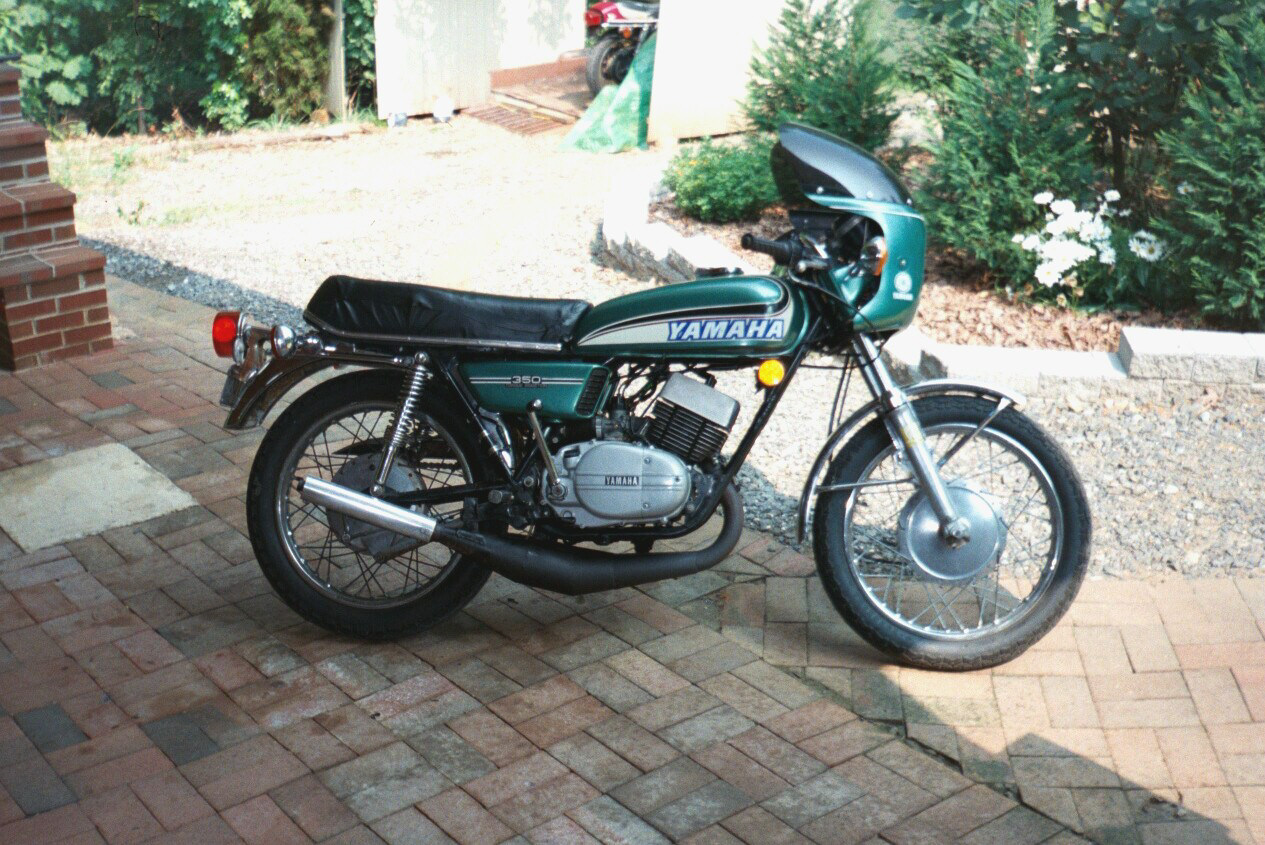

As I totally prefer moderate rearset pegs, instead of the (too far forward) stock peg position, I am now considering converting the rear drum brake on both my XS650D and my RD350A to cable actuation, instead of the heavy and clunky stock brake shaft/arm/stay, plus the required linkage between rearset pedal and the splined brake arm shaft.
DCC, and some other vendors are selling some setups, and on those, the cable ends up in a fairly severe S shape. Basically pointing aft, then down, then aft.
On drum brake Yamaha roadracers, like the TR3, the cable went up in a smooth arc, then down. Obviously, the rear brake plate was designed for this cable path.
I am thinking about having the cable point down at the pedal end, then arcing back towards the brake drum. Just making a pedal that is more or less straight, instead of L-shaped. That way, I can have the stopper for the cable sleeve on/attached to the static brake stay, which is the most convenient.
I believe there are two main objectives here, minimizing cable friction, and minimizing any feedback of suspension movement into the brake. Feel free to provide suggestions, constructive criticism, and ridicule:)
The DCC kit looks like it could be adapted to work way better than the way they show.
