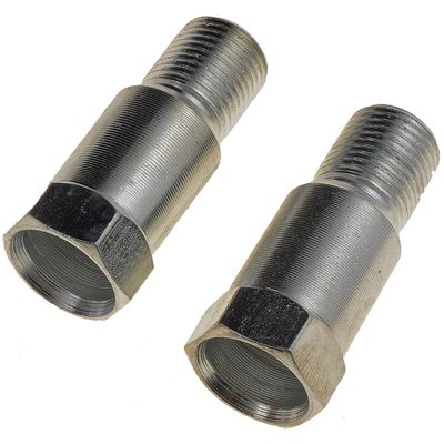

if you don't feel like cutting up a plug, these are handy for making a dial gauge base or piston stop as well.
plug anti-fouler contraptions from parts store, always on the help aisle. think its dorman # 42008
