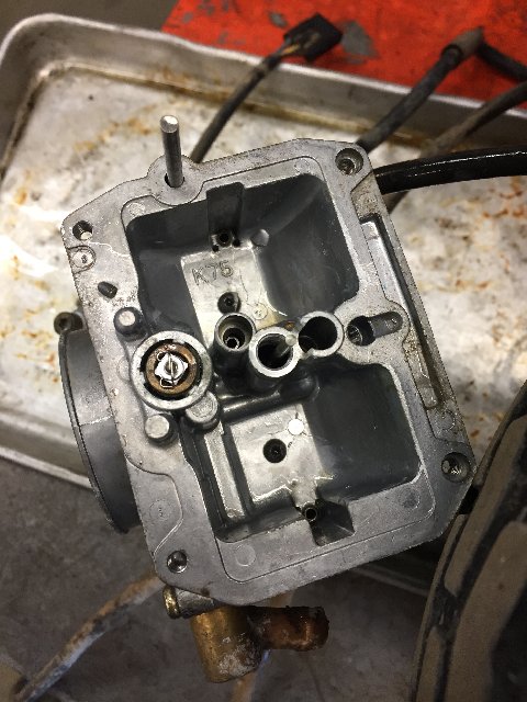

So I tightened my belt and decided to do things on my project bikes that cost $0...and she bought a bike. A freakin' four-stroke, at that! A friend had this '04 Honda CRF250X and needed a few bucks, we have three full-size boys and only two full-size bikes, so I came home to another carburetor to clean. Stinky, green used-to-be-fuel  :brownseat:. And 'kin 'ell, what a carburetor to get out!
Flip the subframe up, three cables, a fuel line, a TPS cable and 106 vent hoses later and it's finally out. Taking it with me to work tomorrow (the carb) for a date with the ultrasonic cleaner.

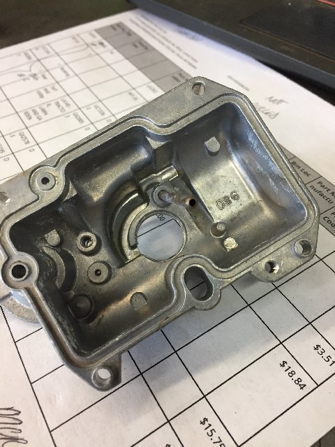

This is the ugliest carburetor...
I've ever been able
to get this clean. Ultrasonic tanks are amazing.

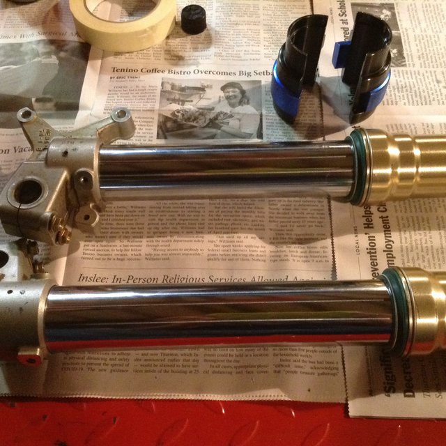

So tonight it's fork seals. These are 47mm USD forks, and a good deal more sophisticated and complex than I've tackled before. I bought a cap wrench and fork seal driver, bushings, seals, dust wipers and oil and pored over the FSM for awhile before diving in. Quite a process getting them apart, but it went OK and the seals are in and the lower legs assembled to the uppers again:

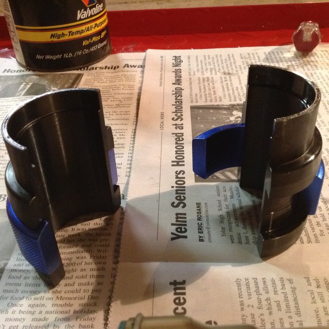

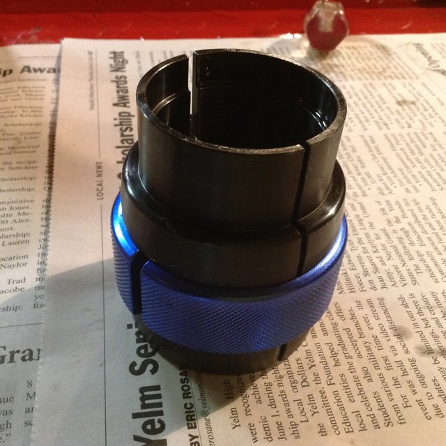

This Motion Pro seal driver is the shit!
It's well made and cleverly designed. These seals (SKF, what's with the green?) went in easier than any I've done in the past
They're not cheap, and of course you need one for every size tube you've got, but you'll never go back to the PVC pipe stunt.
