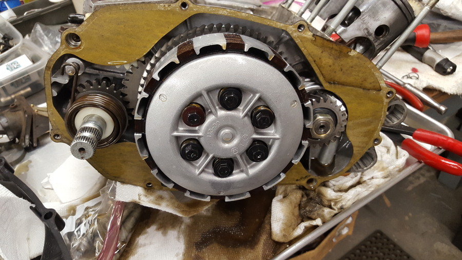

Did you make sure the clutch outer pressure plate clocked correctly? There is 3 timing marks on the outside and one mark on the inside of the inner hub. the pressure plate can go on 3 right and 3 wrong if not clocked correctly.
You can tell if it's right by the pressure plate all the way in pressing against the clutch fiber plate, when wrong the pressure plate doesn't go all the way down to the fiber plate.
You can see the 3 clocking (timing marks) in these pics.
You can see the clocking dot on the inner hub in this pic...it's about at the 5 o'clock position.
From right to left from the pressure plate.
Lifter, ball, pushrod, actuator, (that has a pinned in ball) then the adjuster with jam nut.
Assemble with the adjuster screw loose and all the way out with the cable installed in actuator and cable in handlebar lever assembly and adjuster screwed all the way in. Then mount side cover on engine.
Go to the actuator screw and turn in until it gets almost tight (no clearance) now back off no more than a 1/4 turn, jam the lock nut.
Now adjust out the cable slack at the lever leaving 3-4mm slack.
Use only OEM Yamaha clutch cable (still available for RD400's) as they are teflon lined and are way better than any motion pro or aftermarket cable.
I have used 400 cables on 350's... but had to make a tubing spacer at the engine case as the 400 inner cable is too long to work on a 350 setup.
Lube with Tri Flow lubricant and a cable luber.
rd400greenhorn
Ahh i wondered what those 3 arrows went pointing at...
Thanks again Chuck, i Will check if its on correct
