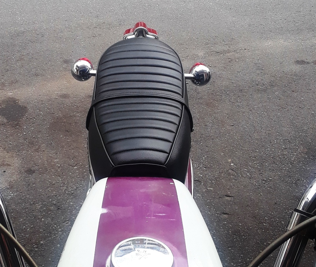

my 70 r5's original seat was wiped out when i got it, but i saved it to eventually get recovered. had an original rd seat on it but the foam was wiped out and it was just getting worse, so i had a local guy redo the original seat. new foam, hand cut, new cover, hand done. even stenciled on the yamaha logo on the back.  Very happy with result!
I really didn't like anything out there offered aftermarket, so i went this way.

Looks like really fine quality workmanship on the seat,....Looks Great!  :clap:
Nice! I'm jealous. Custom seat cover?
all had done from scratch, as was the foam. so, yes.  patterned after the remaining stocker that was left on it.

Great looking seat Mark! Looks even better than factory yet still maintaining a stock appearance!

Wow Mark, that came out beautiful.
Awesome, that seat looks better than new  :bacon:

yeah he did a fantastic job on it, for sure. rode it out to go see dad took the scenic route as well, about 75 miles. very comfy too.
