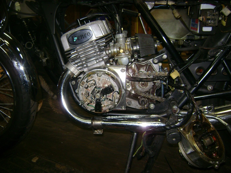

I fit an H1e 2 pickup igntion to an S2 i had, used a zeeltronic controller on there (the vcd04, rd unit, not the triples one) and programmed a proper curve. made a HUGE difference.  or, contact jim hobbs at lakeland services for a replacement box.
h1 was never considered a "widow-maker" btw, that was the h2   :twocents:
#2
i tried the '11' unit, didnt work well at all.
that setup with -zero porting or head-work- and s3 carbs, dencos,  and k&n filters & on 2" runners put down 59HP at the wheel. I give a LOT of credit to the ignition curve.
also note your base curve has to compensate for the cdi's 4k and above advance. so the curve looks funky plotted out.
