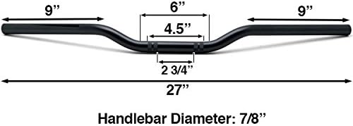

FWIW, I got these cheapo aluminum superbike style 'bars off Amazon for my LC and they are awesome!
Really comfortable bend and rise.
https://www.amazon.com/gp/product/B00KHUB0ES/ref=ppx_yo_dt_b_search_asin_title?ie=UTF8&psc=1
They are pretty narrow, with barely enough room for the master and switchgear/throttle and the stock guages, but they fit fine, and I always chop the bars down as narrow as I can anyway.
For $23 shipped, no complaints at all.
