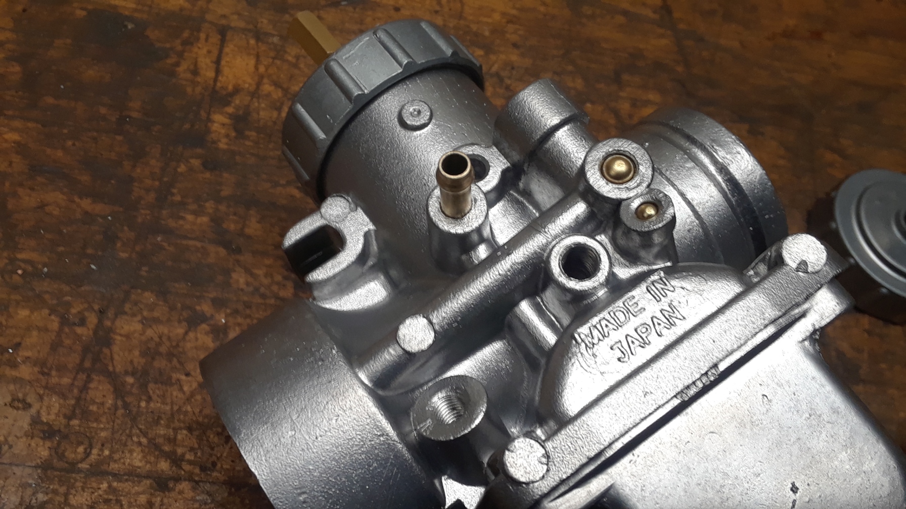

I have still yet to find anything that works better than the carb dip/wd on carbs. actually brings the iridescence back to the zinc/aluminum alloy.  Except for vapor blasting , man, talk about new finish. holy cow.
I have a VEVOR ultrasonic but haven't used it much or tried different solutions.  After seeing Marks' photo I may have to try that! Wow

fwiw, those vm's were vapor blasted.
these were cleaned in an ultrasonic . however, i have some better pics somewhere showing the iridescence on a set of mikunis out of the same mix.
