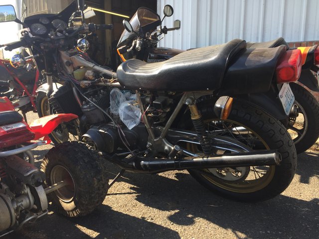

GT750 at a local shop, my man Bill can't get it to fire on #1 cylinder. No matter to me, I stopped in today and noticed it's got a D.I.D 3.00x18 36-hole gold rim on the back! Damn, Gina! There's a 130-something Pirelli on there, and it looks good. No, I can't buy the rim, but maybe a 3.00x18 might be easier to find? Dramatic renewal of purpose!
I like your style, kid.
RustyRD
I spy a Z1-R in the background, maybe a TC , or clone. Either way its there.
