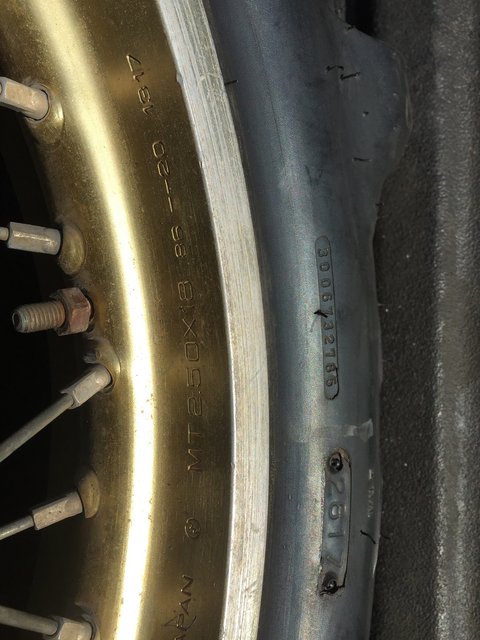

Headlight brackets and THIS arrived today:
Gold, 36 spokes, 2.50x18 D.I.D...wearing a paddle tire!
