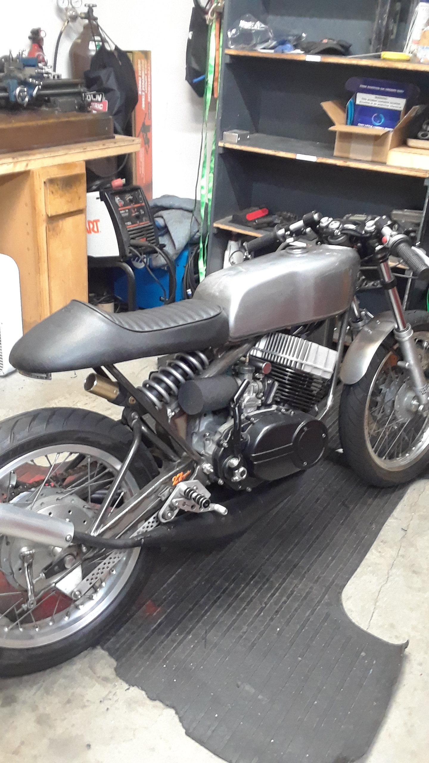

it started as this, a sweet 4130 frame built by danny (27 cycles) we collaborated on, and he did a fan-fucking-tastic job on.
as it currently sits:
the target goal was , arbitrarily, 235 lbs. Just a sort of a guess of where i think i could get it.
I weighed it at wheelers shop at deals gap 3 years ago, came in at 261. way out of line. changed a BUNCH of things, the next year it came in at 246 with a gallon of fuel.
This was pretty good, but wanted to do more to get to goal. I also chased all SORTS of weird tuning issues. I finally got all that sorted out after a few years. Stuff i never have issues with, but thats another story.  :bang:
so, being very skeptical of the scale at the bike shop,(its an outside unit, just old and im sure hasn't been calibrated in a decade or more) I wanted it measured on a certified scale . so happens a friend of mine works at a metal fabrication house ( mass production stuff) and just had their scale calibrated.
I know, for a fact, over the past year i have shaved over 6 lbs off just in comparative components changes (weigh one vs the other and swap), plus all the titanium hardware ive swapped onto it. there's been a LOT.
The final weight, no fuel, on a certified scale, is 245 lbs with no fuel. But otherwise ready to ride.
I'm extremely happy with that.  I'll continue to shave oz here and there when i get the bug to do do, but not an all out assualt on mass reduction as i was for the past 10 mos.
