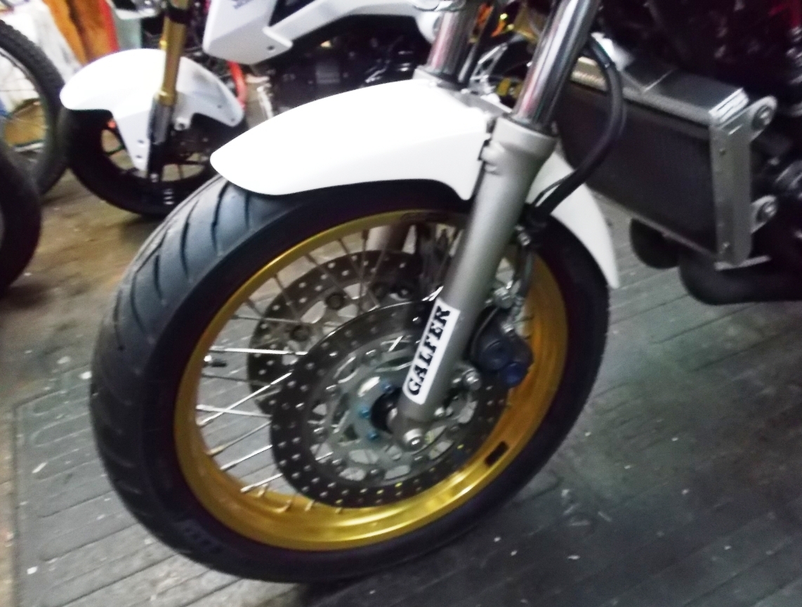

A couple things are happening, most notably the elimination of 7lbs of unsprung weight hanging off the front end.  It was no secret that there was way more brake than necessary on this bike.  It didn't occur to me until riding it that there was way too much brake.  Down a caliper and rotor, it should be so much better.
Also of note, the crown of the piston was a solid dark color with slight brownish stain on the underside.  As I understand it, this means I am rich or it's oil related.  I am running 36:1 atm.  I read 32:1 is a number, as well.  Mainly looking for a base on oil and mix, to situate myself with the least amount of variables to focus on carb tune.  At 40/230/P2, I am surprised to be jetted rich.
I THINK THE PILOT MAY BE A BIT LARGE. TRY A 37.5. where is the air screw?  MY method is to throw as much fuel at it as i can till it I lose performance a hair, then back up 1.
and yeah, i had a dual disc setup too. and did the same thing. but it looked tits and was ridiculous braking :gentleman:

Back with updated beauty shots and to report. The Economy clutch makes a world of difference. I thought there was a chance I was losing a decent amount of power in the clutch. It's scary good now. The transmission is oiled and quiet. I think I averted disaster there.
Put it all back together with 1.85 on timing, and holds 6psi in the leakdown.
Temps can reach 165° during a succession of traffic lights, but cruises below 150°. I'm really happy about this.
The CB650 forks are decent, but I want to see what I can do to make them better.
It's incredible what deleting 7lbs of unsprung mass does. I'm hoping the weight in somewhere near 300lbs, though I have no idea. Regardless, 7lbs is a chunk.  It feels much better, though I still have quite a bit of chicken strips to deal with to really know.
The bike feels all around better now.  Power delivery is pretty crisp.  If I lay it on, it want's to shudder the back wheel.  Not sure if this is something I can tune out with the rear suspension, or if it's just the nature of power to weight.  Regardless, grip is good and it's getting off like a rocket.
