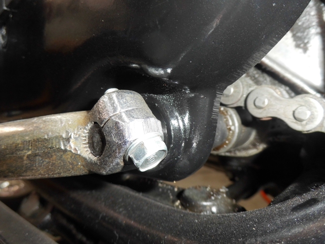

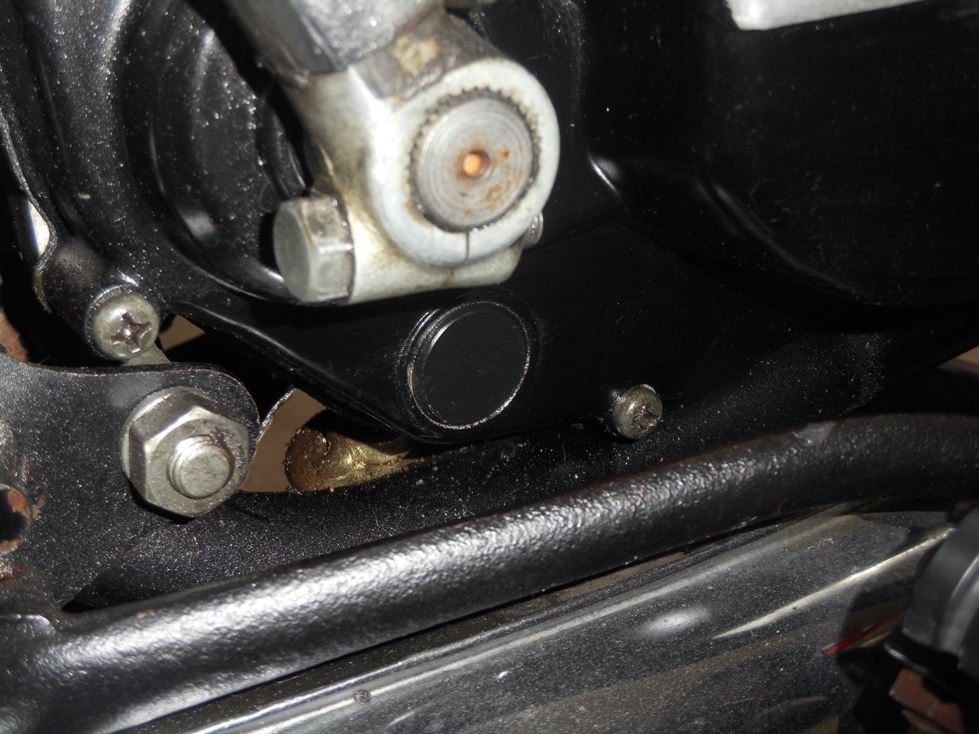

   I also have some DS7/R5 Clutch side covers which have the 'boss' for the optional Right side shift.  Some are not drilled out or machined for the seal, and some are machined but have a solid rubber seal in place (same seal as the shift fork rods use on the left side).  Both are original from the factory that way.
that ive seen, have a few actually .

as a follow up, was working on barney today a bit and looked ad the engine covers, they are both original tot he bike and lo and behold has both the pocketed LH one (hard to see in pic but its there) AND the plugged shift shaft RH one.  I also know this bike was built in (late) 69
however, the ds7 has neither
So I'll assume that we really don't know when or why Yamaha made or installed these different cases.
No rhyme or reason?
id say 1970 and some crept into 71 as leftover parts. neither 72s i have have them, nor did the 71 i had but it was a later 71.
