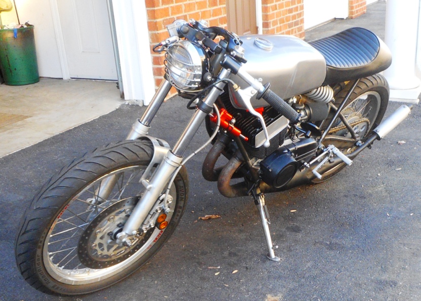

thats the cable i've used in the past. you -may- need to open the adjuster nut at the perch a bit and yes, tap the metal block m8x1.25
i think i cured this one a bit tighter than stock to clear the headlight bucket, but you can see the cable works quite well with low bars. fwiw, the frame geometry IS stock on this.
LMS
Ah ha, I get the routing now, pix says it all, makes sense now. Cool bike.
