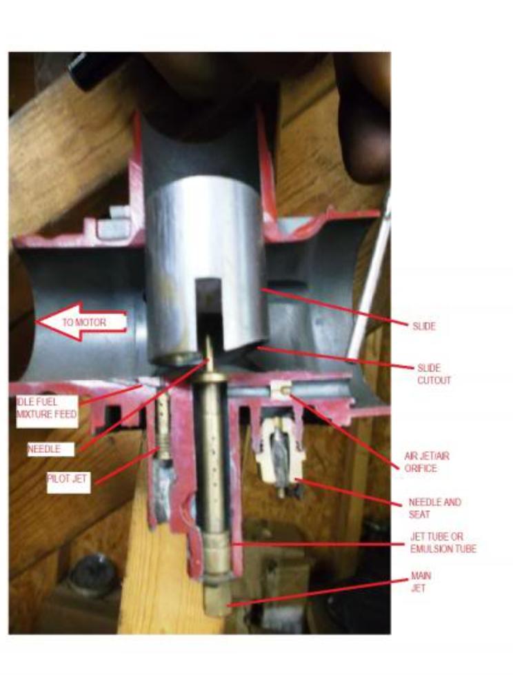

dumb question. did you make sure the slides are in the carbs the right way. easy to mix up, the cutout needs to face the air filter. IF they dont, swap the left and right slides.
310 seems really steep on the main but verify the slides, then timing then test ride.
reason i say slides is the idling bit. .02
ElFuegoBlanco
#9
Whoa whoa whoa. The cutout on the slides? Are you saying the groove alone the side of the slide faces the right (brake) side of the bike?
There's a tiny nub in the carb body that I figured (apparently incorrectly) corresponded to the groove along the side of the slide.
If the cutout means the sloped part of the bottom of the carb, they are indeed in backward.
Edit: or the slides are swapped between carbs  :bang:
I believe that 99% of 'us' have done that at one time or another...
swapped between carbs. like said, it happens.
in this pic of the carb cutaway, the air filter would be towards the right.   :cheers:
ElFuegoBlanco
Quote from: m in sc on June 16, 2022, 01:06:00 PM
That's exactly what happened. Thank you so much for that.
