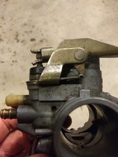

As for the crossover, I'm sure it was connected, but I have been having choke issues. The choke won't stay actuated. When I release the lever, the choke disengages. I don't think it's related, just an observation.

Well since mine is on the floor in pieces, this is mine open and closed, 77 400, pretty sure stock. It will definately stay on riding it slowly, warming it up, I dont remember if it vibrates closed if you forget to close it, feels like it might but I think I can ride it with it on.  The little cam like arm is pretty stiff and, without looking it up, I'd guess is what makes it "spring" closed or open.
yes thats stock. make sure OP that the spring is above the lever perch like in pic, not below it, ive seen that mistake a lot.

Quote from: Clem710 on June 29, 2022, 09:46:53 PM
Thank you! The pictures were exactly what I needed to figure out what was going on with the choke lever. The spring arm was in the right place (thanks M) but had nowhere near the same angle as yours relative to the lever. the lever would almost get caught by the cam, but failed to catch more than half the time  You're right, it's quite stiff, so I don't know what happened to it. Maybe left in the actuated position for 35 years? I removed it and bent it just slightly upward to match the angle in your pictures and it seems to be much more functional now.
