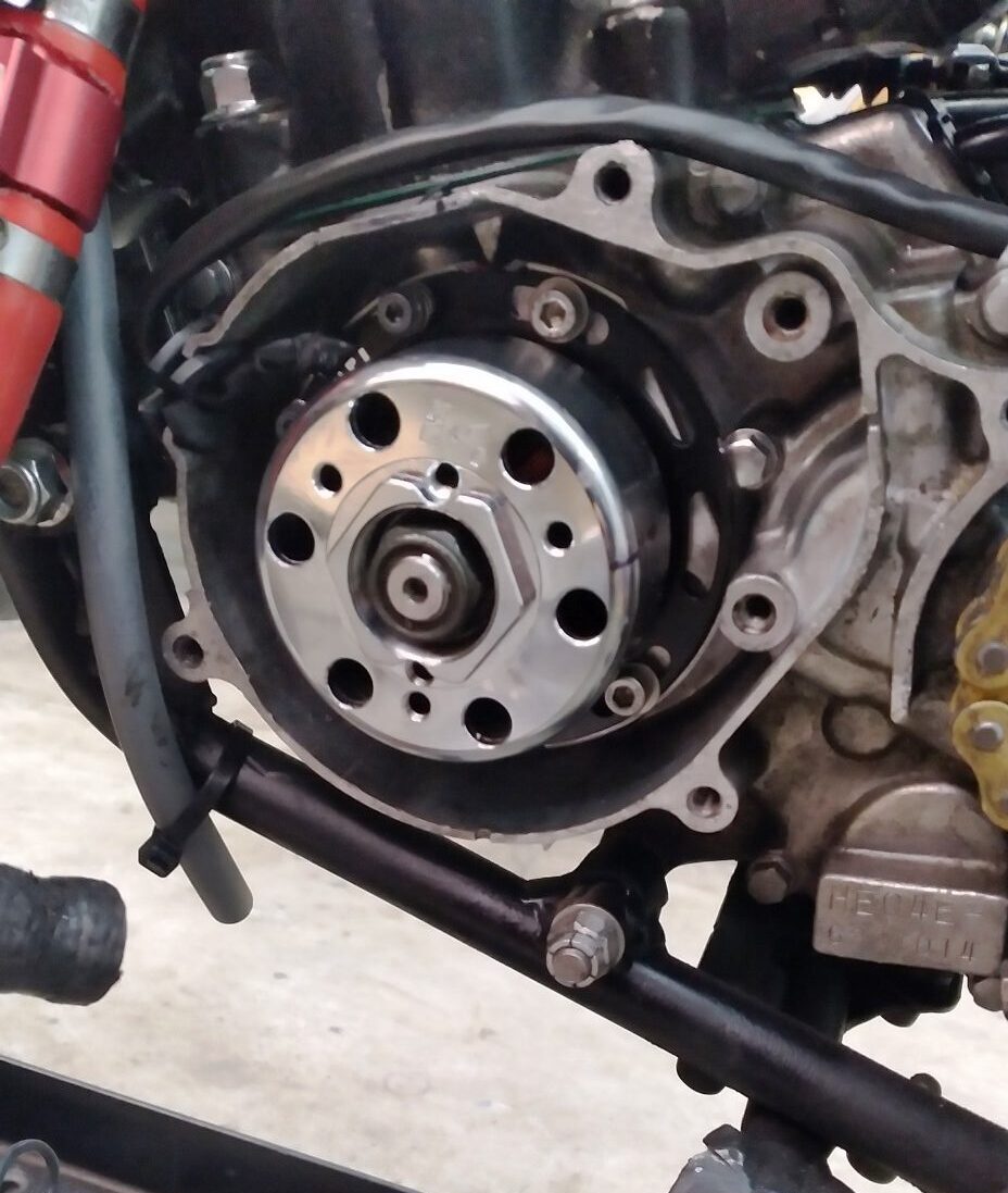

One thing, I didn't lap the rotor, so the flywheel is sitting approx 3.5mm or 9/64" from the stator plate. Is that normal?

Hopefully I'll have some kit to try soon and narrow it down.  Does the flywheel clearance at 3.5mm or 9/64" from the stator plate sound about right?
I'm thinking that perhaps the flywheel magents are slightly proud of a small part of the coil.
this is how mine sits on my bike (rd)
you def cant see any of the coils. .02
on the cr85 motor:
ajb
That's odd. I'm doing a teardown on my 400 and just removed the HPI. This is how my coil plate is positioned.
hpi" border="0
