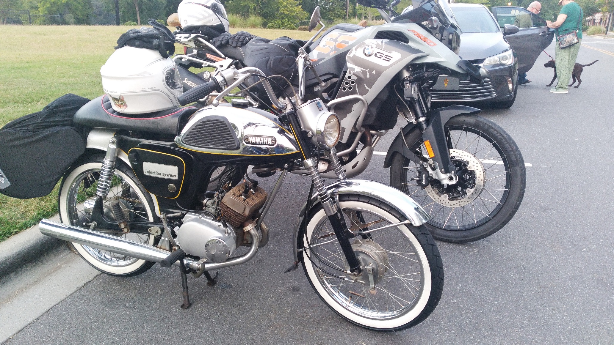

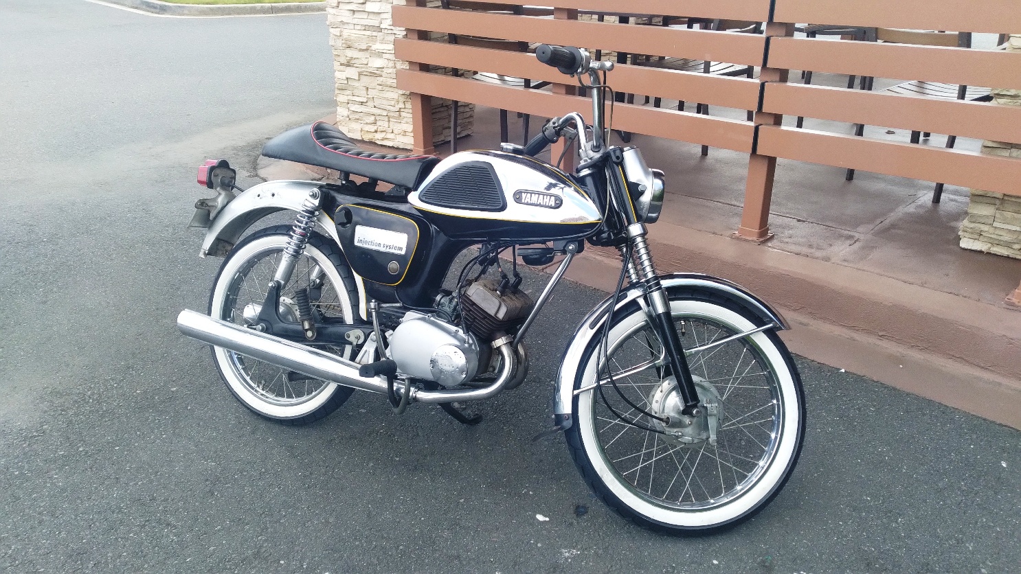

did a bunch of stuff to this over the past week. I'll start off with .. the testride went well.
*note: seat is temporary, need to get stock one sorted.

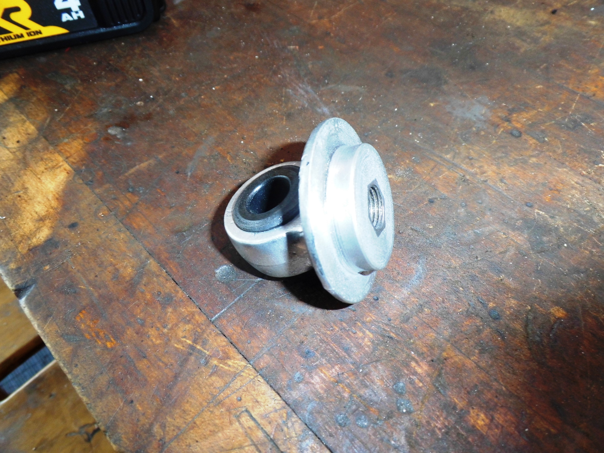

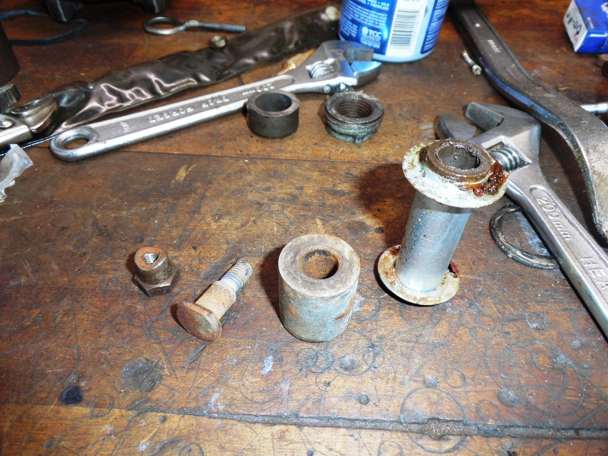

the rear hub was a mess. there was a pipe fitting for a spacer... so i fired up the lathe and made a new one.

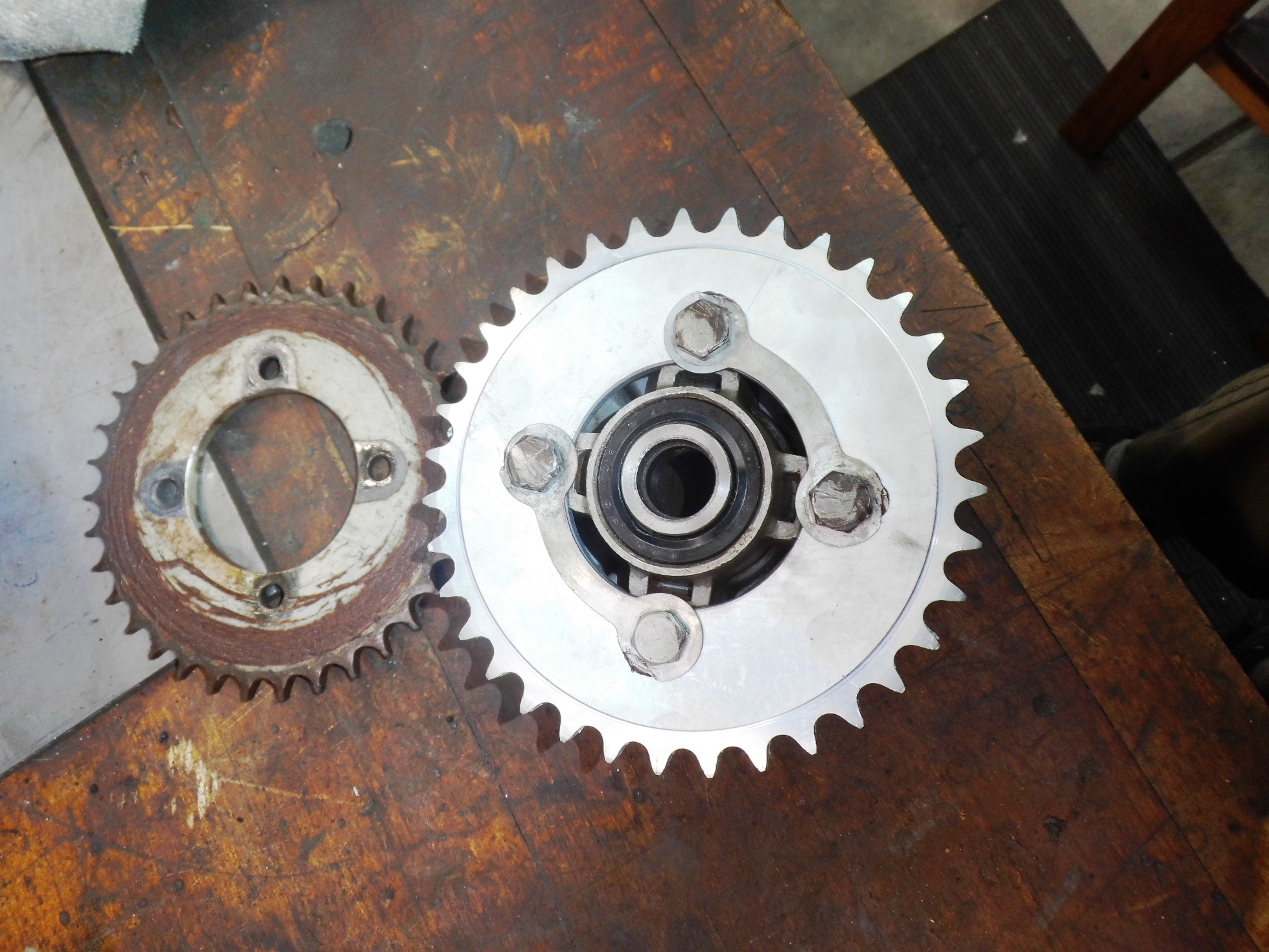

new sprocket, and all new bearings.

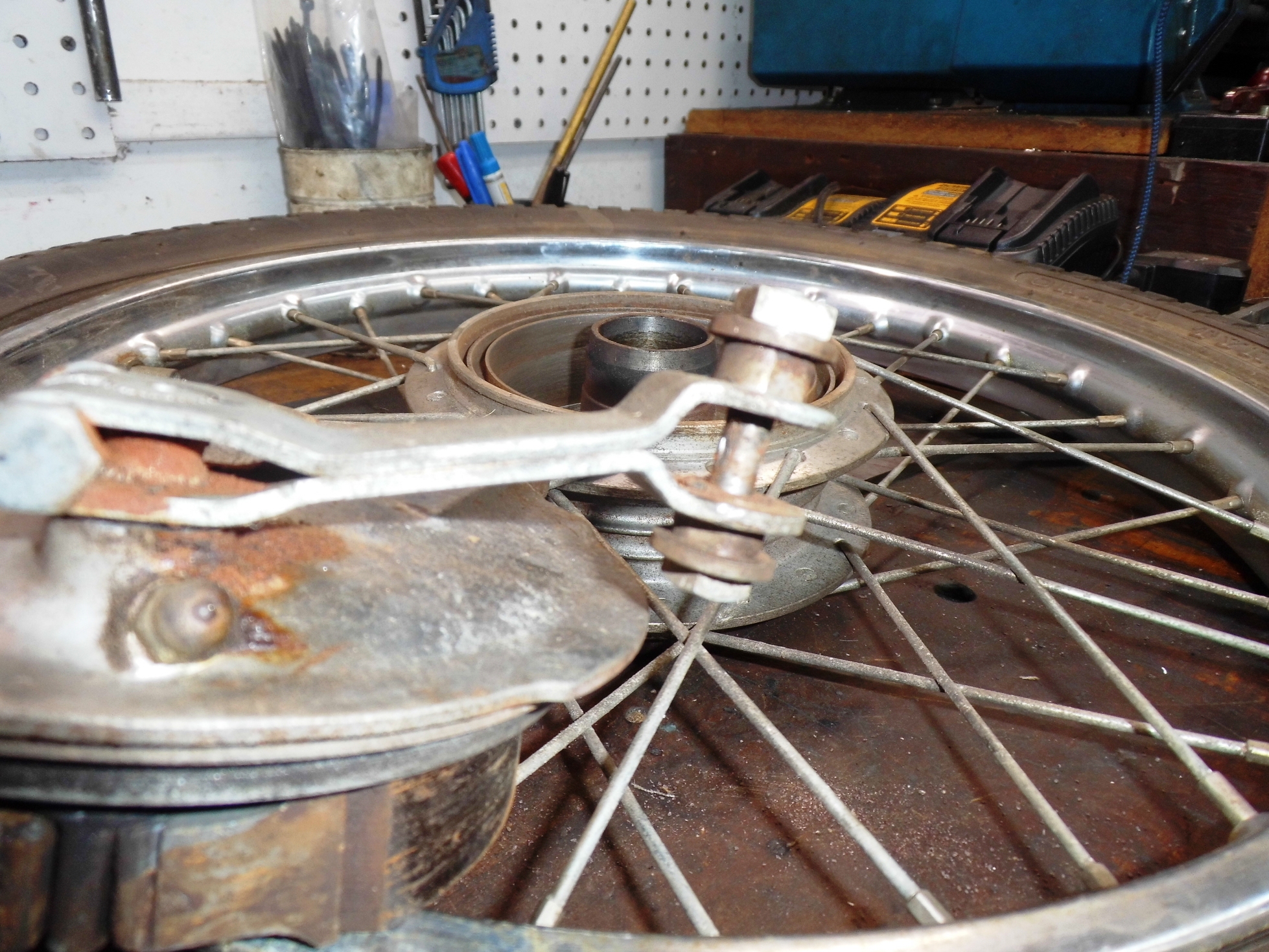

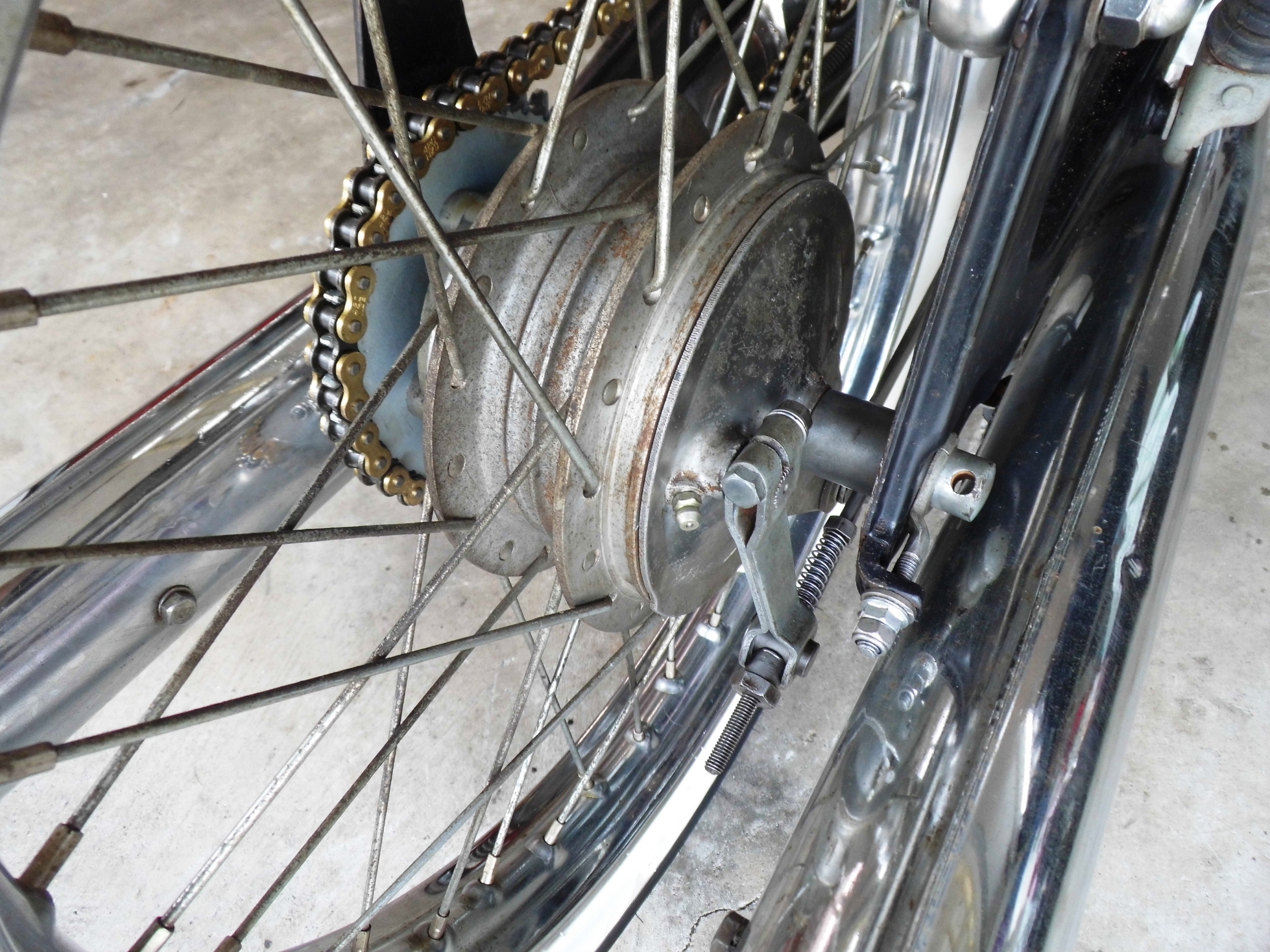

at some point the rear wheel came loose, prob from a slung chain. so the brake linkage was all fucked up. luckily i had the basic parts that were missing and was able to repair the rest:

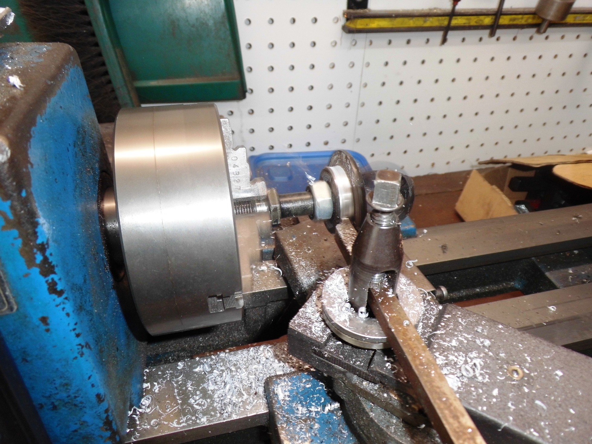

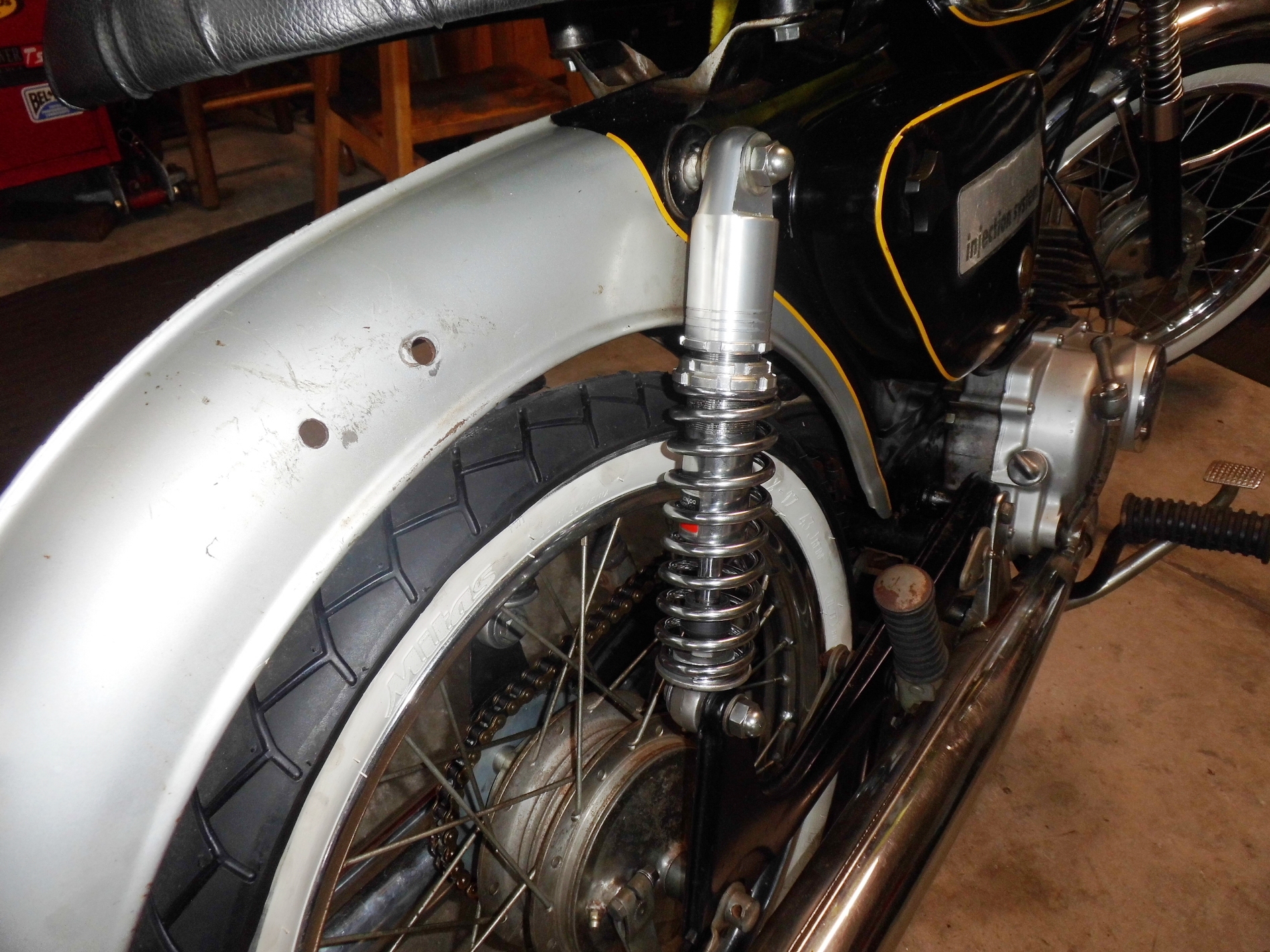

the shocks worked well, but they were a bit long. dug around int he shock bin, found some shorter tops, but had to lathe down the shoulder 2mm to fit the spring, and tape the hole to 12x1.25 to fit the shaft. while doing this i thought about it and realized... these are nitrogen, i can run them upside down. so mounted them where the shock spring doesnt possibly hit the fender anymore. much better.

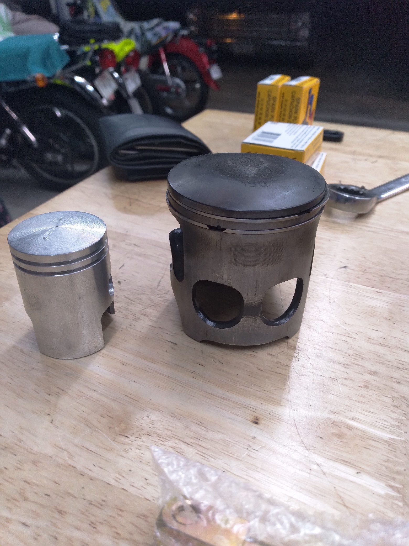

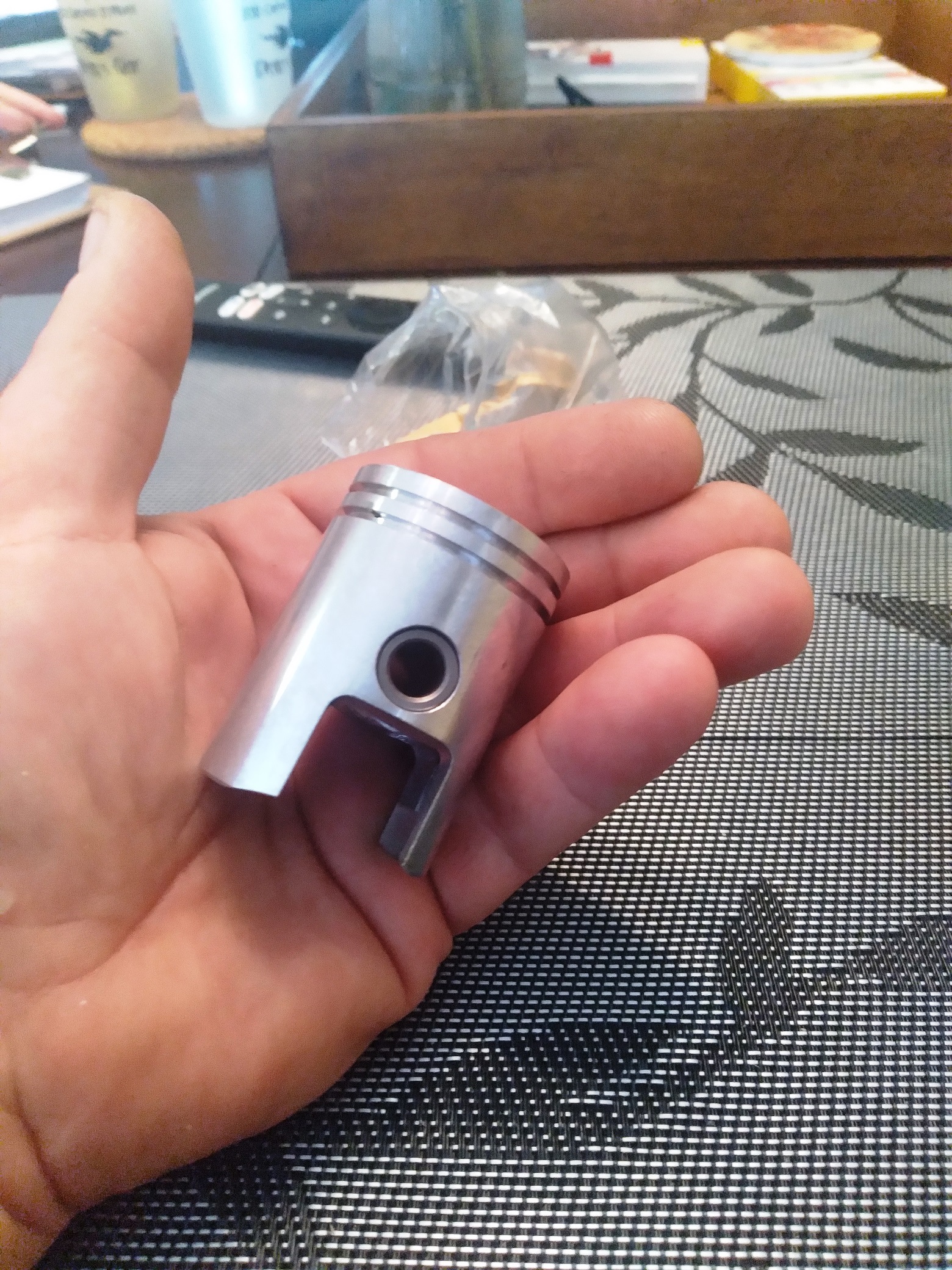

new tiny pistons and wristpin bearings and rings. check out the 'hap jones' box.  :cheerleader:
next to a cooked rd piston for size comparison:

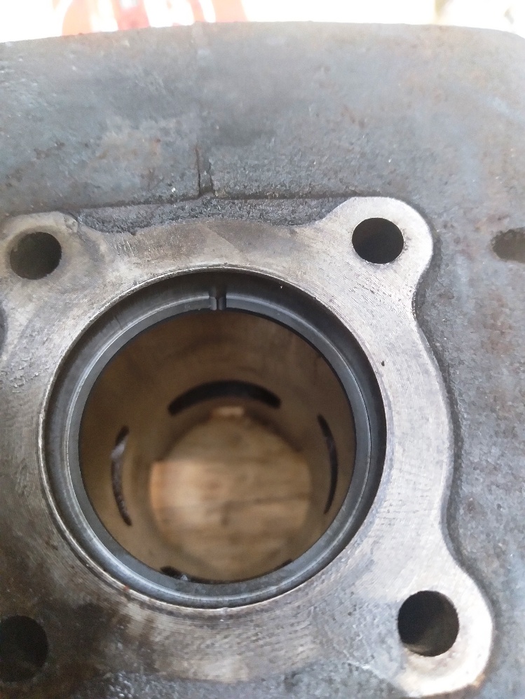

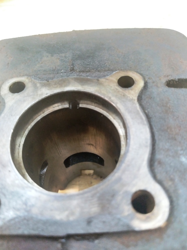

the rings were the culprit, heres 2 shots.
this is the left cyl. 1st pic are the rings I took out  :eek: (yes it ran but was loooow on compression). the bores looked ok and measured fine:
same cylinder with the new rings set in.

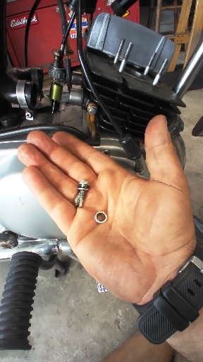

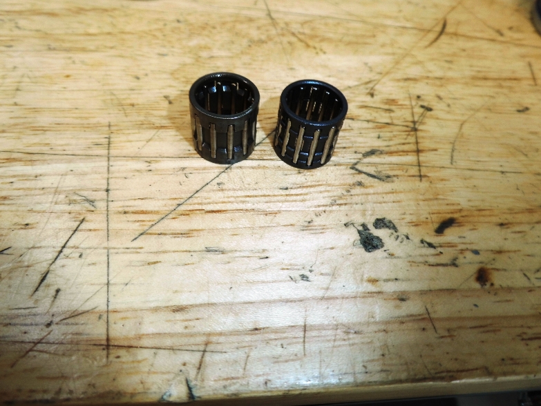

new wristpin bearings, thanks to Russ (SoCal250) for the crossover. https://www.2strokeworld.net/forum/index.php?topic=55.0
bonus, they have an extra roller on there so a more supportive bearing.
(new one to right)

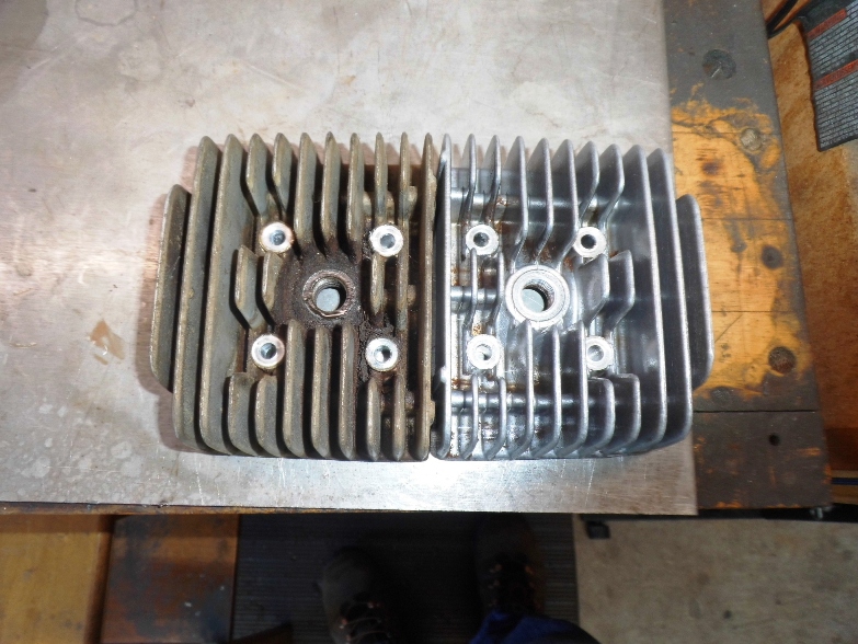

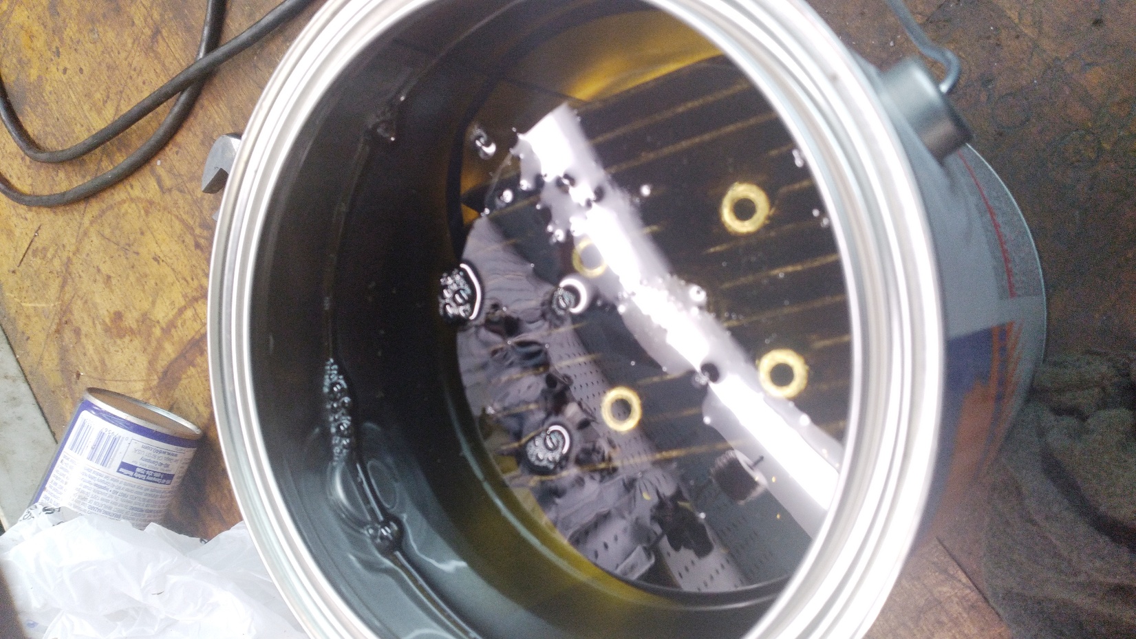

heads small enough it fits in the carb dip tank.
and i never do this, but then ultrasonic cleaned with household cleaner, then again with carb cleaner in tank.
some gun brushes later and some wd40 and:
this was prior to its last shots with brake cleaner.

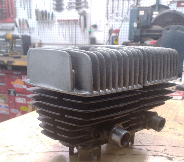

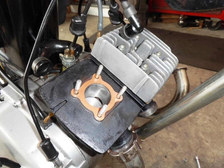

i -may- have raised the cyl skirt transfer port sleeve at the base a bit  :devil: , but after a hit with the brake hone, then ultrasonically cleaned, repainted, heres the jugs and heads.
new pistons and hand cut base gaskets in:
fresh stat-o-seals on the injection lines:
and 3rd start w topend.  :celebrate:

Pretty cool! Those pistons make my RD125 look like a big bore  :dawg:
