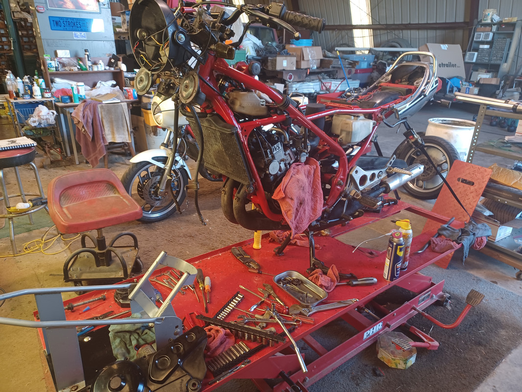

Wheels and forks off. Hopefully I will get the wheels to the local bike shop this week to get the tires changed.

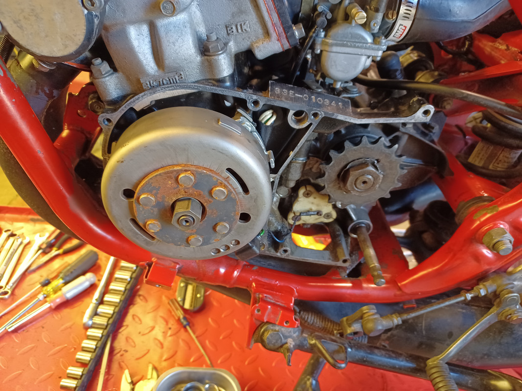

The chain and rear sprocket didn't look too bad. But the front sprocket is hooked badly. I have a new chain and sprocket set from Economy Cycle that will get installed.

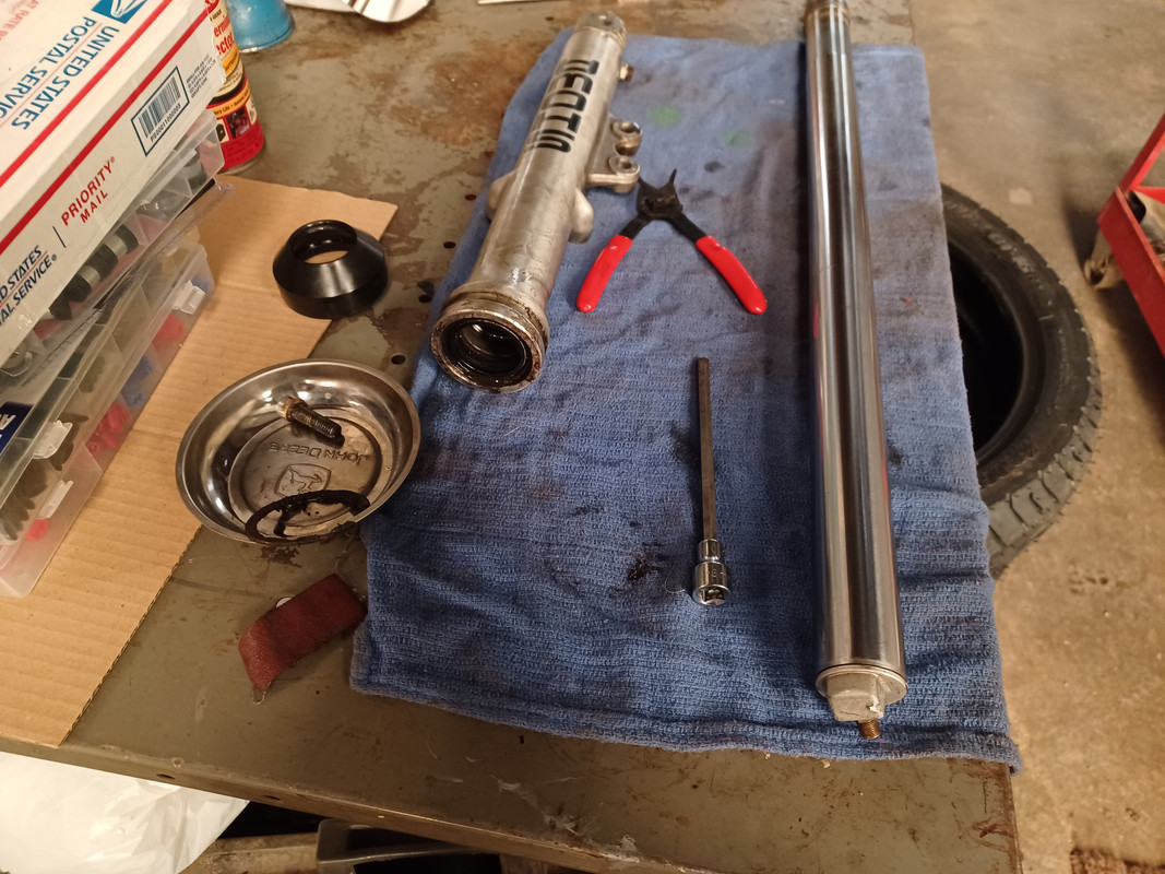

RH  fork nearly disassembled. It fought me all the way thus far. Usually I can take the snap ring out and put air into the valve and the seal will pop right out. No such luck today. I aired it up and soaked it with PB Blaster and heated it up with my heat gun to no avail. Then I got the damper rod bolt out and got the seal to move using the internal fork bushing that is bigger than the seal like a slide hammer and got it to move but it didn't come all the way out before the tube came out of the fork lower. I will use my seal puller tomorrow to coax it the rest of the way out. I did have presence of mind enough to get the fork cap loose before pulling it out of the triple trees unlike the previous owner or one of his minions who put the inner tube in a vise and buggered it all up.  :bang: :bang: Thank goodness it was right next to the lower triple tree far enough up the tube that it will never contact the seal.( Not visible in this picture, apparently I turned that part down when I laid it on the table)
#118
20 minutes with the heat gun, my seal puller and a folded shop rag and the old fork seal came out. I took the dremel with a steel brush to the seal area and snap ring groove and got it cleaned up. Then I got the fork lower scrubbed up and took the wire wheel to the retainer snap ring and finished it with a good bath in the parts washer for the fork lower and inner tube. Ready for reassembly, new seal and Progressive Suspension spring. I will put this one together before I disassemble the other one.

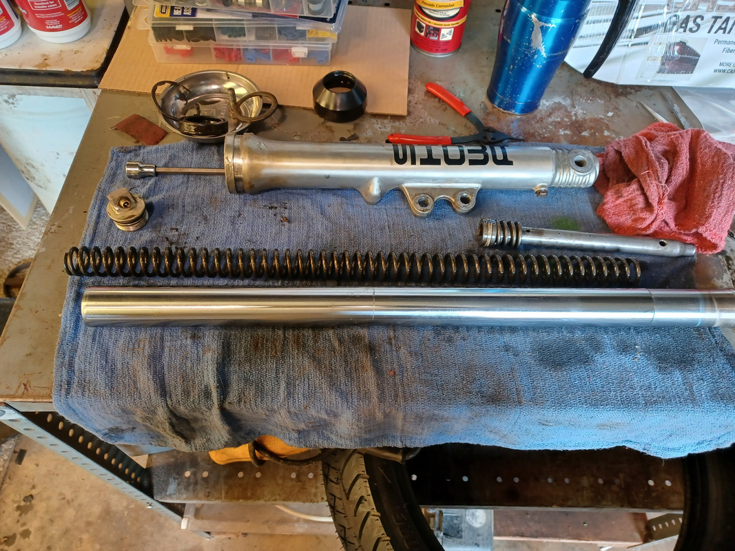

RH fork reassembly was straightforward and uneventful thus far. The Progressive Suspension spring is identical in length to the I assume stock spring I pulled out. The seal went sbout 1/2 way by hand and the seal driver did the rest. The instructions say no PVC spacer is required even though they include the PVC and a big flat washer. I can't recall if I used any spacers on my white RZ and again didn't keep good notes. The plan for tomorrow after chores and before work is to add fork oil and finish the RH side up then begin on the LH side.
