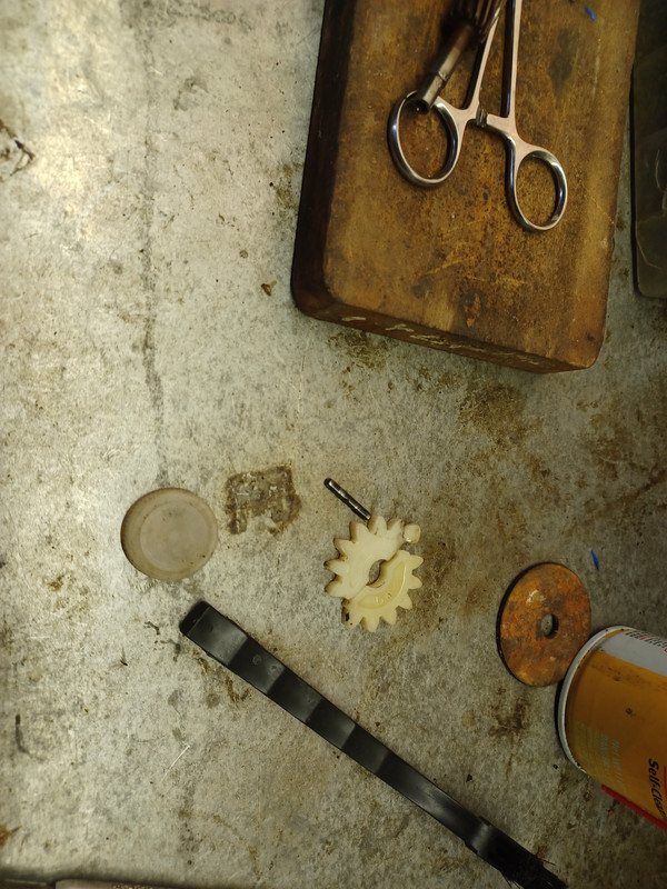

Yesterday's project was the removal of the clutch cover and subsequent  R&R of the clutch.

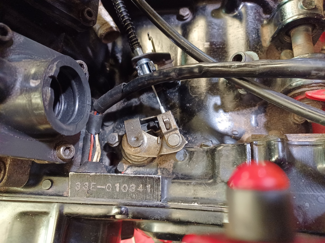

Pretty much what I expected after I found the bent and stuck tach driveshaft. One half of the tach drive gear was lodged up near the shaft and the other half was lodged behind the shift shaft. A tooth and the drive pin were laying in the bottom of the clutch cover. I removed the retainer clip and washer from the shaft as well. I did a thorough inspection with particular attention to.the right hand crank seal and no damage was noted.
My new Yambits clutch cable is a perfect fit.
