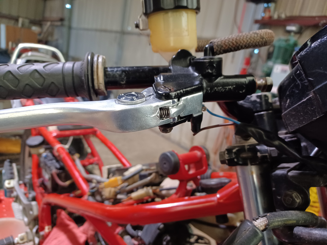

I got notification from NK Racing that my adapters have to be made as he didn't have any in stock. 10-14 days to manufacture and 4 days after that to get them here. So I took my factory RZ master cylinder off and dug out my spare R1 master cylinder
#43
I removed the factory brake light harness and scrounged through my spare Yamaha wires and made up a new harness rather than cut the end off of the factory brake light harness.
The brown wire is correct but I didnt have a green with a white stripe so I went with a blue with a white stripe and made note of it in my service manual. All that's left is to put two terminal ends on to push on to the R1 switch and a little heat shrink and Bob's your Uncle on the front master cylinder and brake light. I ordered two of Evans Ward's finest refurbished Blue Dot calipers Thanks Brother Evans :patriot: :patriot: and they will be here soon.
I found out today why the throttle was slow to return while I was installing the R1 master cylinder. The throttle tube has a big ragged chunk missing out of it and the grip rubber is dragging on the handlebar. I went on Yambits and ordered the correct single cable 29L replacement for non USA bikes and it is on the way.
