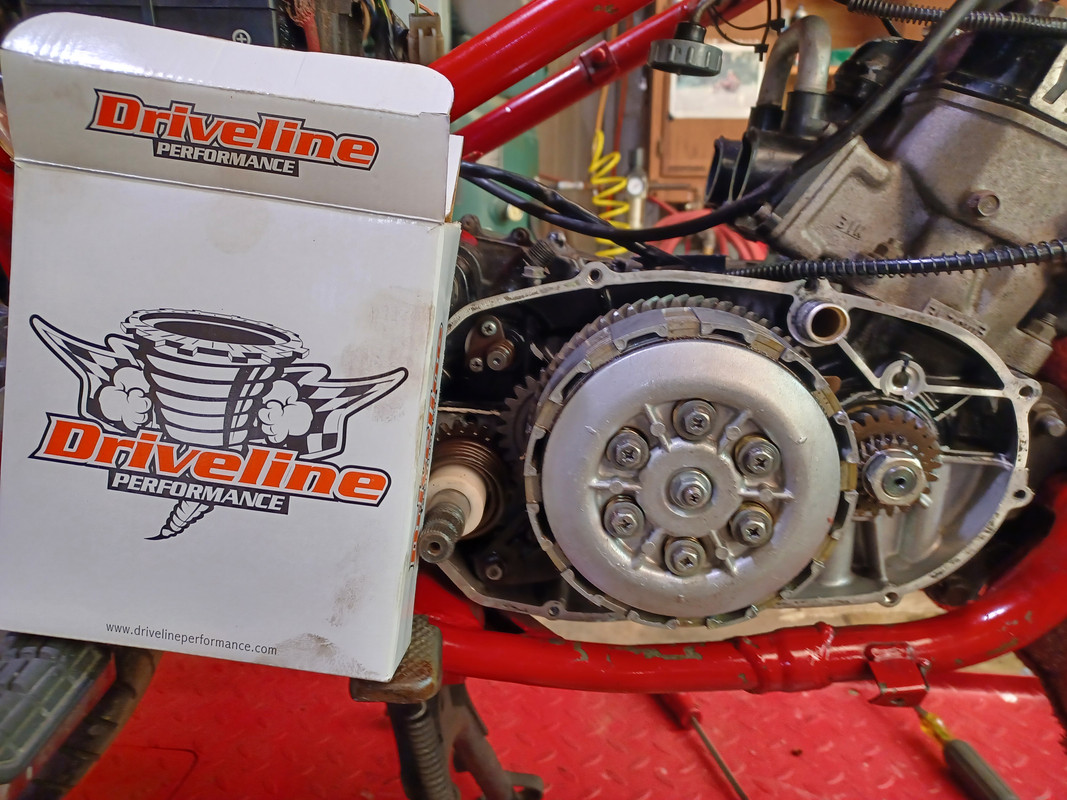

And I digress, worn clutch removed. Rubber dampers discarded. New Driveline Performance FZR 1000 friction plates (soaked overnight in Lucas 80/90) and steels installed along with thier 10% stronger than factory springs. Pull feels good comparable to the white RZ with a similar setup.

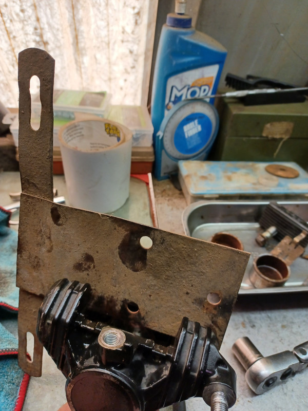

Today was brake day. Had to break out the impact to get the rear caliper bolts out. Pistons came out pretty easy and a trailer license plate bracket served to block the holes so I could get the 2nd piston out.
