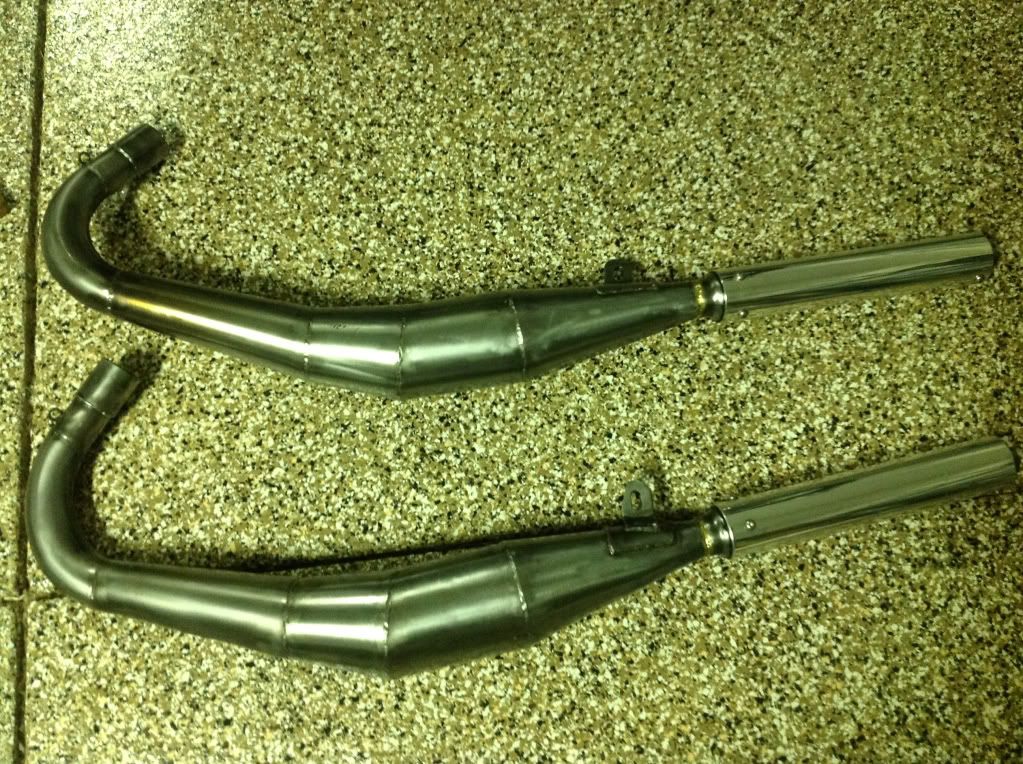

I'm kinda wanting to leave my new specII pipes in the raw and wondered if anyone has used VHT clear with any success? Thank you in advance. Ashley

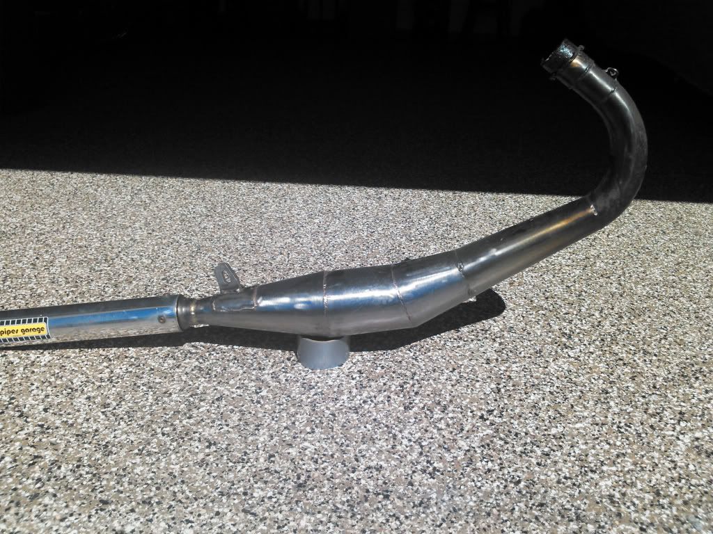

FYI, here are some Mop N Glowed Spec Ii's...
The top pic is a fresh coat, the bottom pic is after some running period...
Spray bottle or rag.  Doesn't really matter how it goes on.
Burns in a nice bronze color.  This is after a few years only one application when the pipes were new.  Reminds me I should pull em off and wipe em down again.
