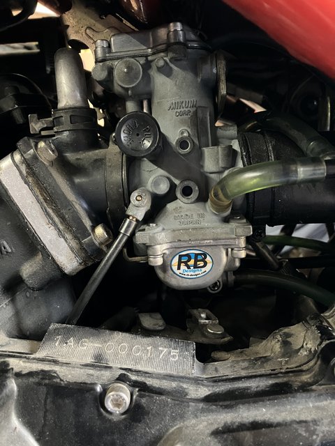

Always lead with a picture, right? Some of you may remember when I bought these modified RZ350 carbs from RB
designs in Portland, but I don't. They're taper bored to, I think, 29mm and have dividers added. Supposedly jetted  and ready to use, and I figured I'd use them someday.
Well, I think it's someday. The RZ has developed a symptom that I don't want to live with any longer. Right at  1/4 throttle, 6000 RPM it slows, as in, loses speed. Crack the throttle open and it takes off. The symptoms are worse when it's hot outside, and I can just notice it on a cool morning, so I believe it to be a rich condition. My theory is that either the needle jets or the jet needles have worn and have screwed with my ratio. I'm ready to pull the carbs off, examine the needles and jets to check my diagnosis, then chuck the scientific theory out the window and put the modded carbs on. I will open them up and check the jetting first, and the fuel level. This should be fun.  :wave:

These are the RB carburetors; clean as the proverbial whistle inside. 420 mains and what appear to be 20 pilots. 20 seems way too small, but I may not be seeing the numbers correctly, even with my assistant.

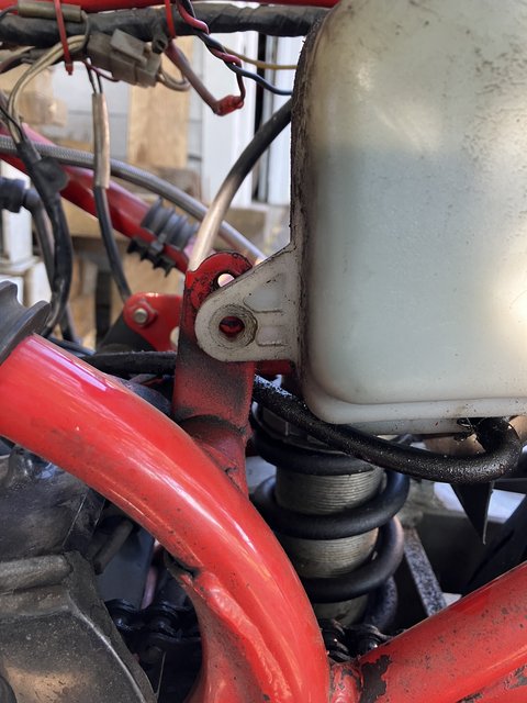

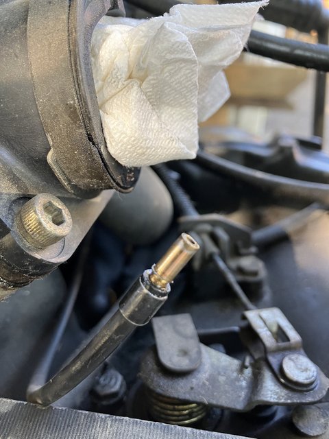

I brought a set of parts donor carburetors back from Dennis's place after the Tiddler ride, and today I pulled my carbs off. I disassembled them to verify jetting; 420s, same as the RB mixers. I don't see any difference between the 39,160 mile needle jets and the donor carb jets, and the needles look fine as well. Maybe the wear is too small to be seen with the naked eyebulb. It can't be a cleanliness issue...
There were a couple of hiccups in the disassembly process:

That's a very early production engine you have there. #75 of the run
