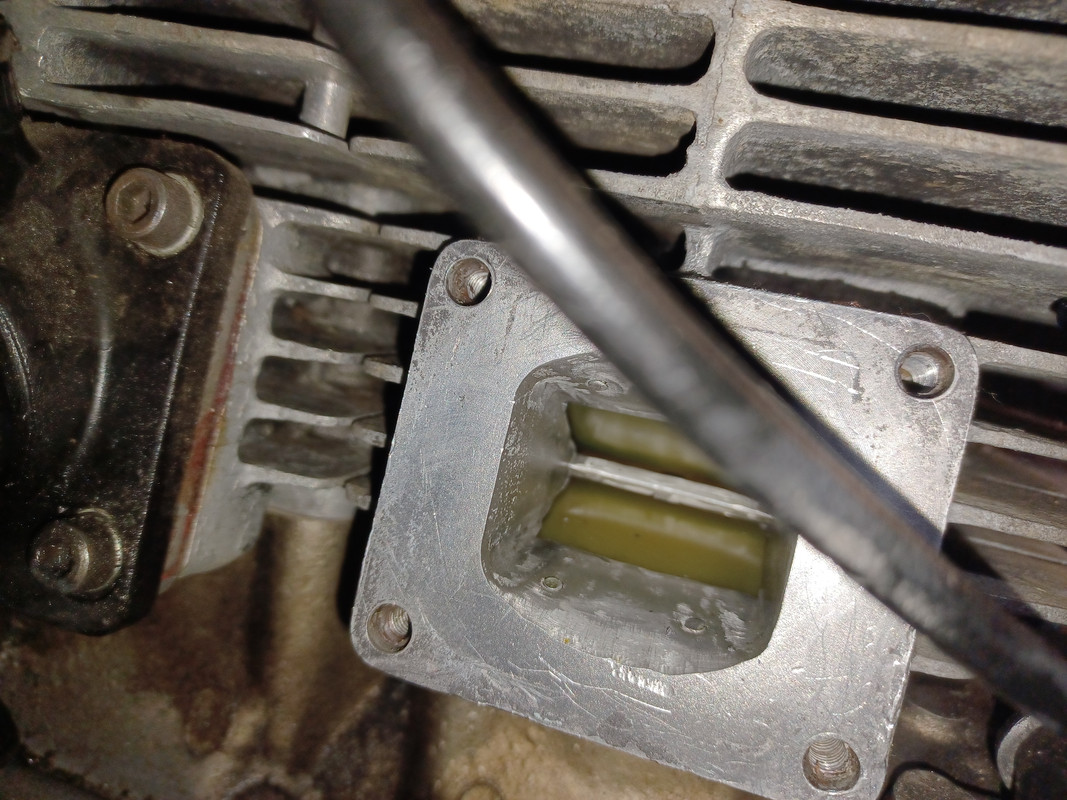

The winter is coming, had a little time to get some electrical sorted. I bought it as non-runner last September. I cleaned the points up to get spark. I have cleaned the carbs as best as I can. This is my first time working on a bike. The timing was ok, have not timed it with the dial gauge. I just wanted to see whether it would fire up. I have cleaned the tops of the pistons. Looks like it is standard.
The right cylinder runs hot to touch, the left is cool. It does not have the gasket between the exhaust header and the exhaust. Doesn't sound anything like what I have heard here from some of the videos posted??
