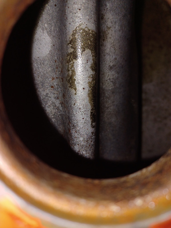

I took the tank off and inspected it with my borescope. I didn't find  anything. Took the petcock completely apart and other than the already known no screen or standpipe filters didnt find anything amiss. I will be ordering a new petcock from John at Economy Cycle along with some wiring stuff I need for the Zeeltronic setup on my Gray Ghost RZ.
I did electrolysis on this tank when the bike was first resurrected years ago. The inside still looks good. I filled it up today with Evapo-Rust full strength and I  will leave it in there until my Economy Cycle order arrives. I figure it is a good idea to make sure and already had the 5 gallons of Evapo-Rust on hand since the Gray Ghost tank job.

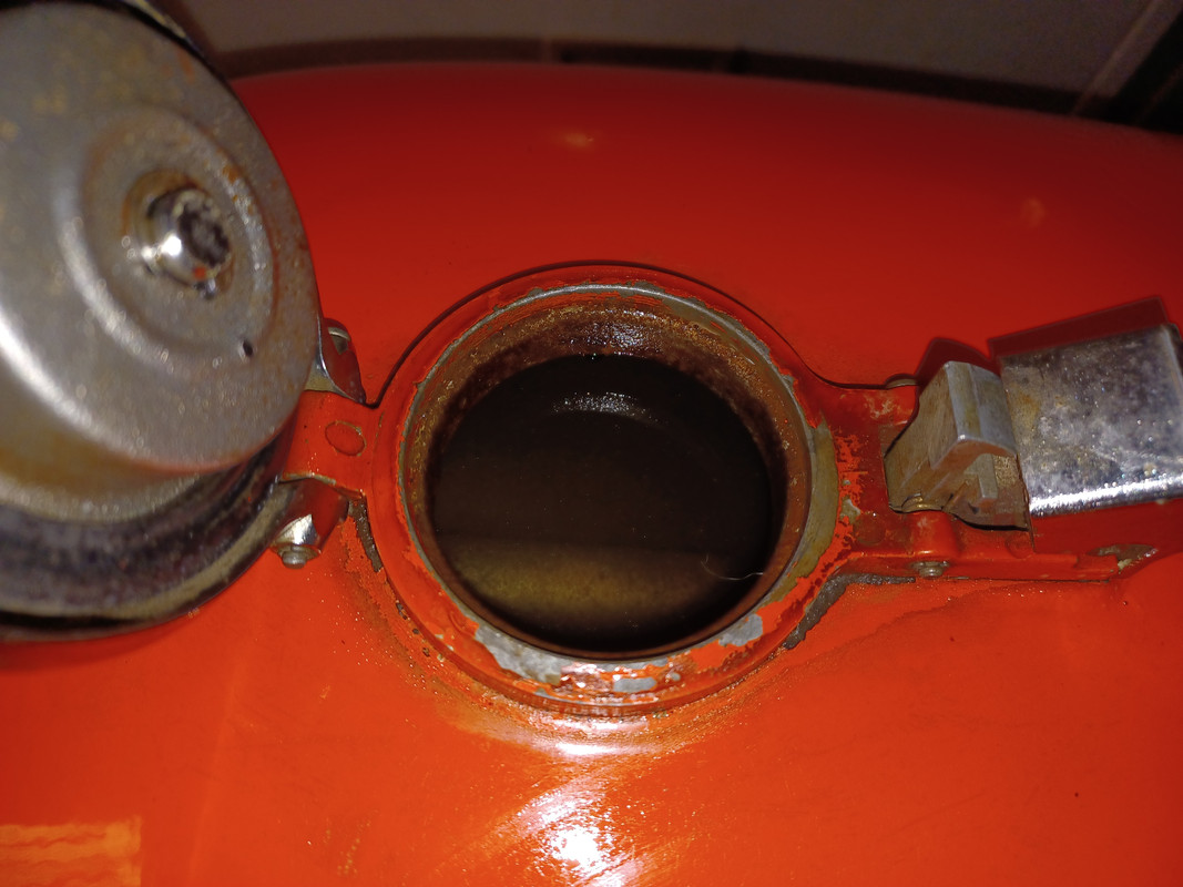

#14
The tank after a week filled with Evapo-Rust full strength. I did a water rinse then put a 1/2 gallon of WD 40 in the tank and coated it thoroughly, drained that and blew inside the tank with the air hose.

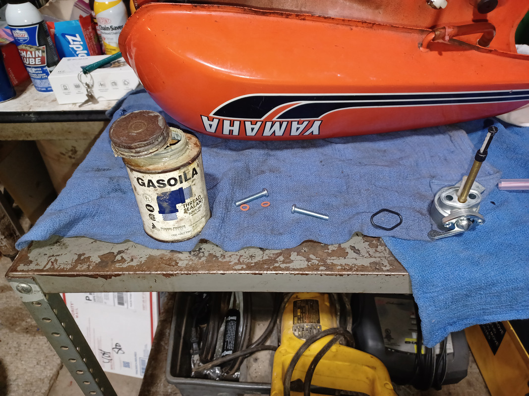

New petcock from John at Economy Cycle prepped and just a touch of Gasoila on the threads, sealing washers and tank gasket. A bit of trivia, M in SC took me to the hardware store in Charlotte if memory serves in 2004 and we bought that can of Gasoila to seal the threads on the Pingel for the Phoenix Project. Still good after all these years :patriot:
Another quality product from John at Economy Cycle :righteous: Thanks John!!
Filled it up with gas. No leaks. Fired up on the 2nd kick. It was raining and cold so no test ride until later in the week. More to follow. Thanks M in SC for your guidance as always.
