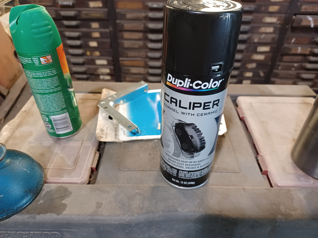

Bead blast complete. Blew all the residual beads off. Ready for an acetone wipe down and a good bake in the shop oven 200 degrees for 20 minutes and a fresh coat of Duplicolor caliper semi-gloss black.
#37
Baked in my very short lived shop oven at 200 degrees for 20 minutes at 200. Acetone and tack cloth wipes before and after. Can says 7 days for complete cure. It is a bit shinier than I anticipated. But it is done. Cylinders, power valves, new bushings, seals and o-rings, and a can of caliper paint for the cylinders boxed up and ready to ship to SC.
