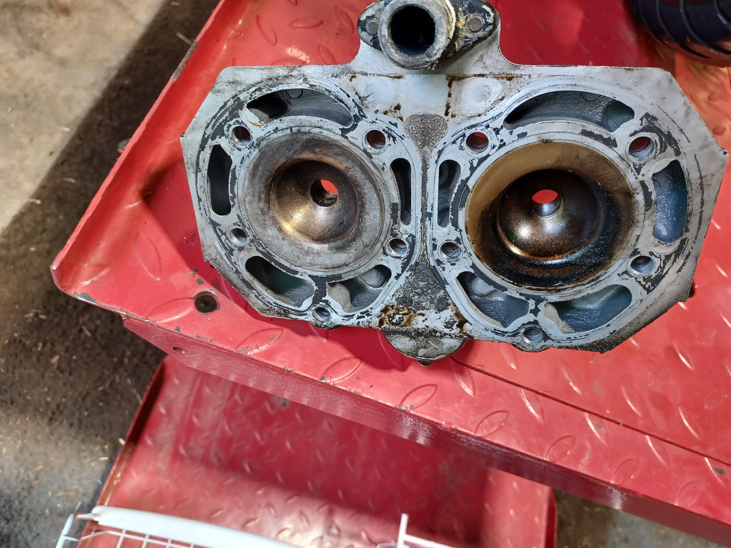

Had time today to get the head off and see the carnage.
Head is undamaged except for less than optimal threads in the LH sparkplug hole.
It will get timeserts.

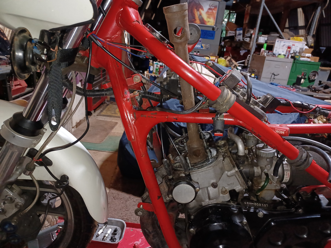

Had a couple hours of shop time today so I did my 1st time ever top end removal on an RZ. Investigation determined the seizure is actually a nearly locked big end rod bearing on the left cylinder. It was a challenge to get it apart.
Minimal if any damage to the bore. Some slight ridges on the exhaust port side but nothing you can catch a fingernail on. If time permits tomorrow I will continue disassembly.
well since the crank was going to be replaced anyway, this is good. got lucky the rod didn't go way off enter on the bearing and punch a hole in the case.
Very lucky indeed. On we go. I hope to do some more tear-down this afternoon.
Could have been a lot worse!

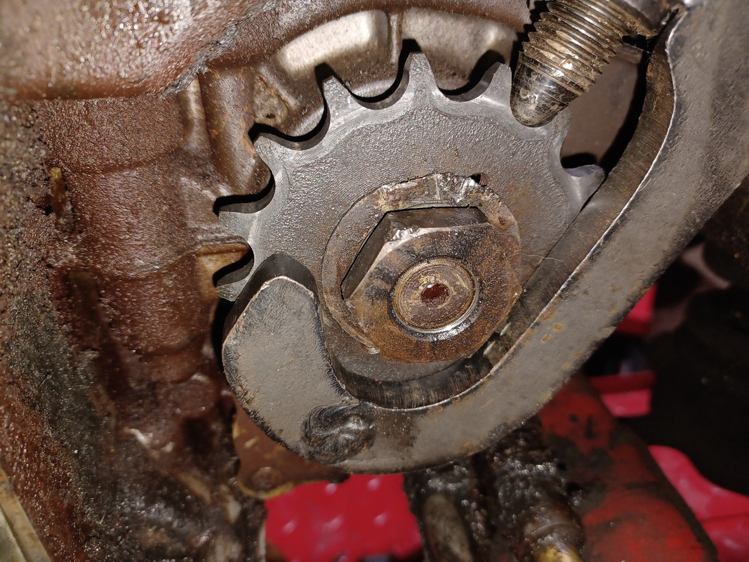

Thank God for the sprocket tooI bought from Rick Brett 20 years ago. Sprocket, hardware and the spacer behind it bagged and tagged.

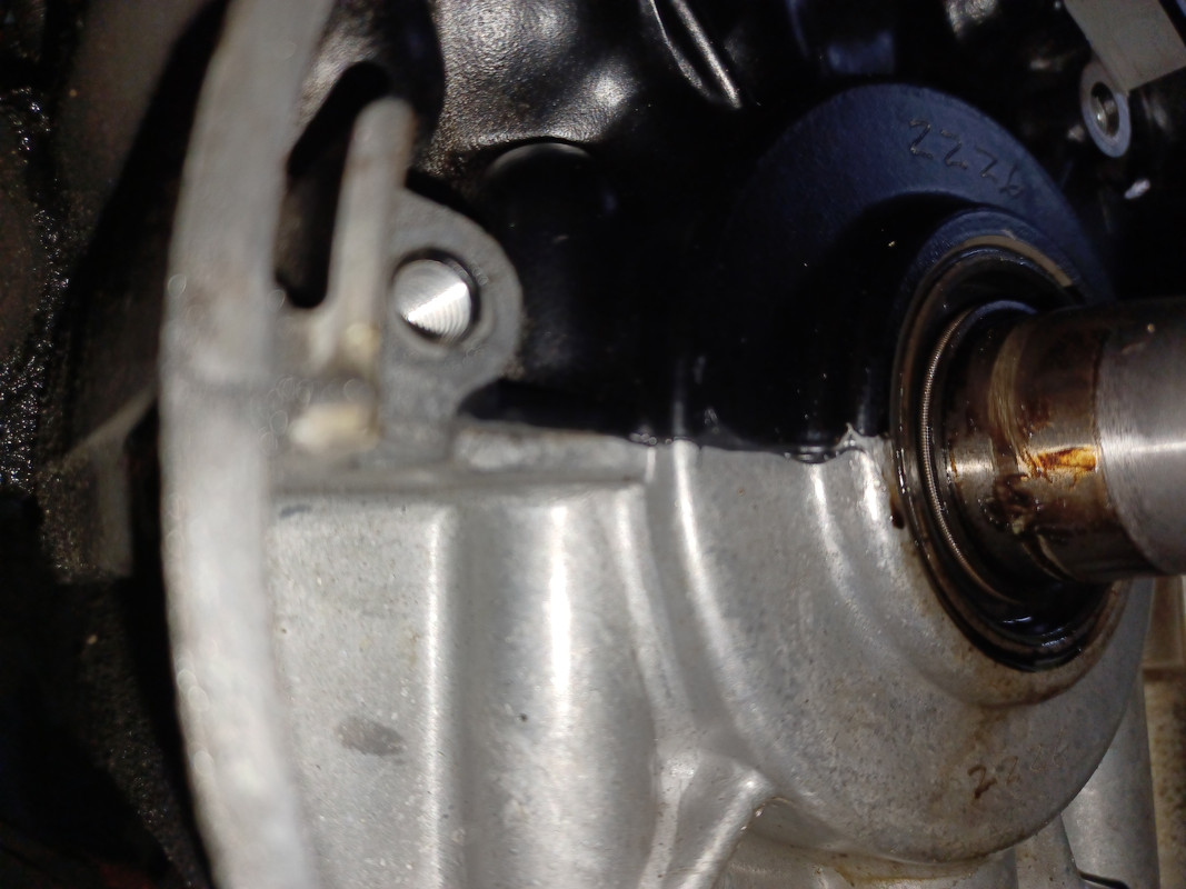

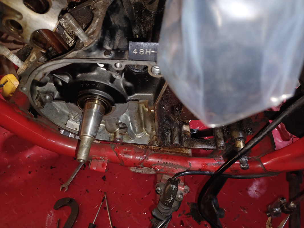

Left side stripped. The rotor was uncooperative at first but the 1/2 inch drive impact on the puller convinced it.
