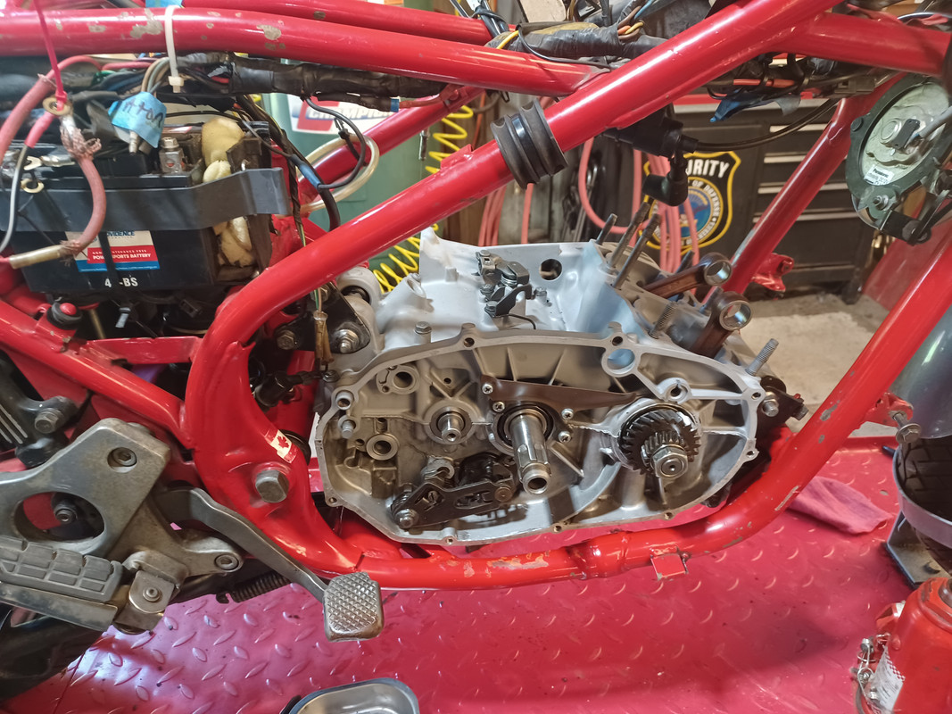

Made a little more progress today.

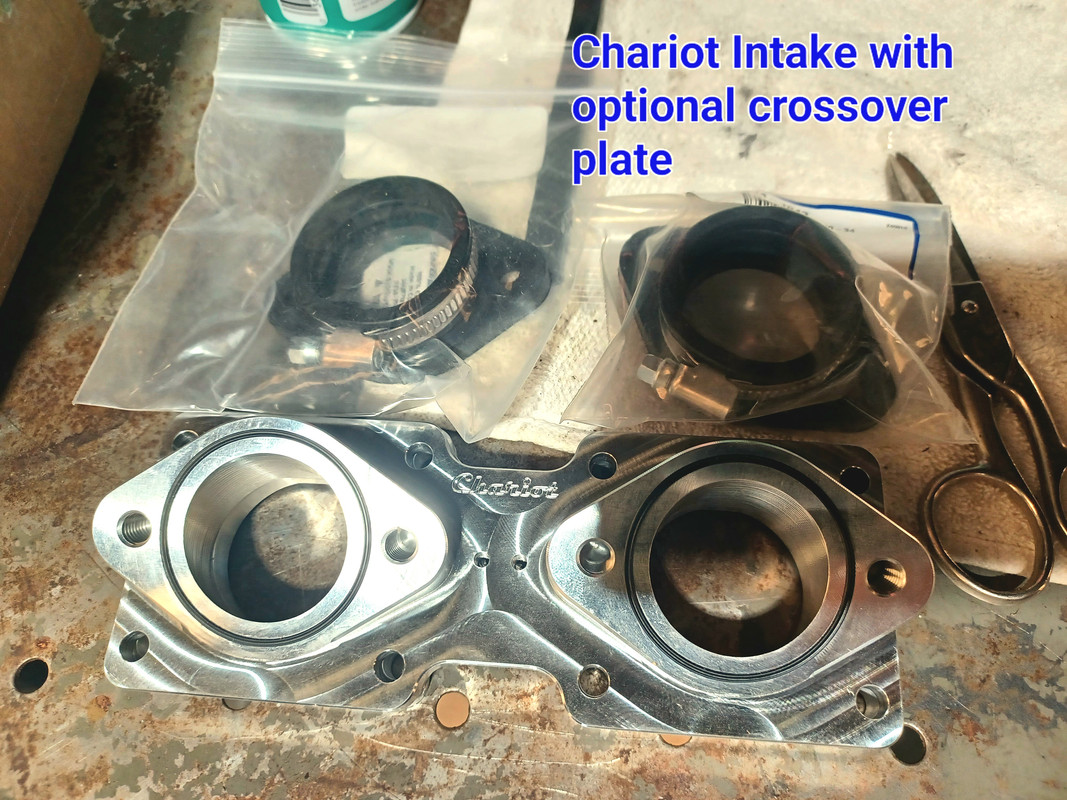

Ordered a billet intake from Chariot performance today.

Motor back in the frame

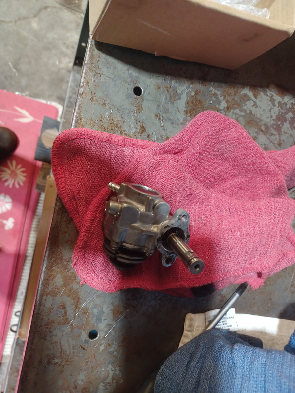

Oil pump pulled and prepped for shipping to Arrow in the UK for rebuild/421 upgrade.
Chariot billet intake arrived today. I chose this one because you can run it with or without the internal crossover plate. Initially the plan is to set it up to run with the crossover.

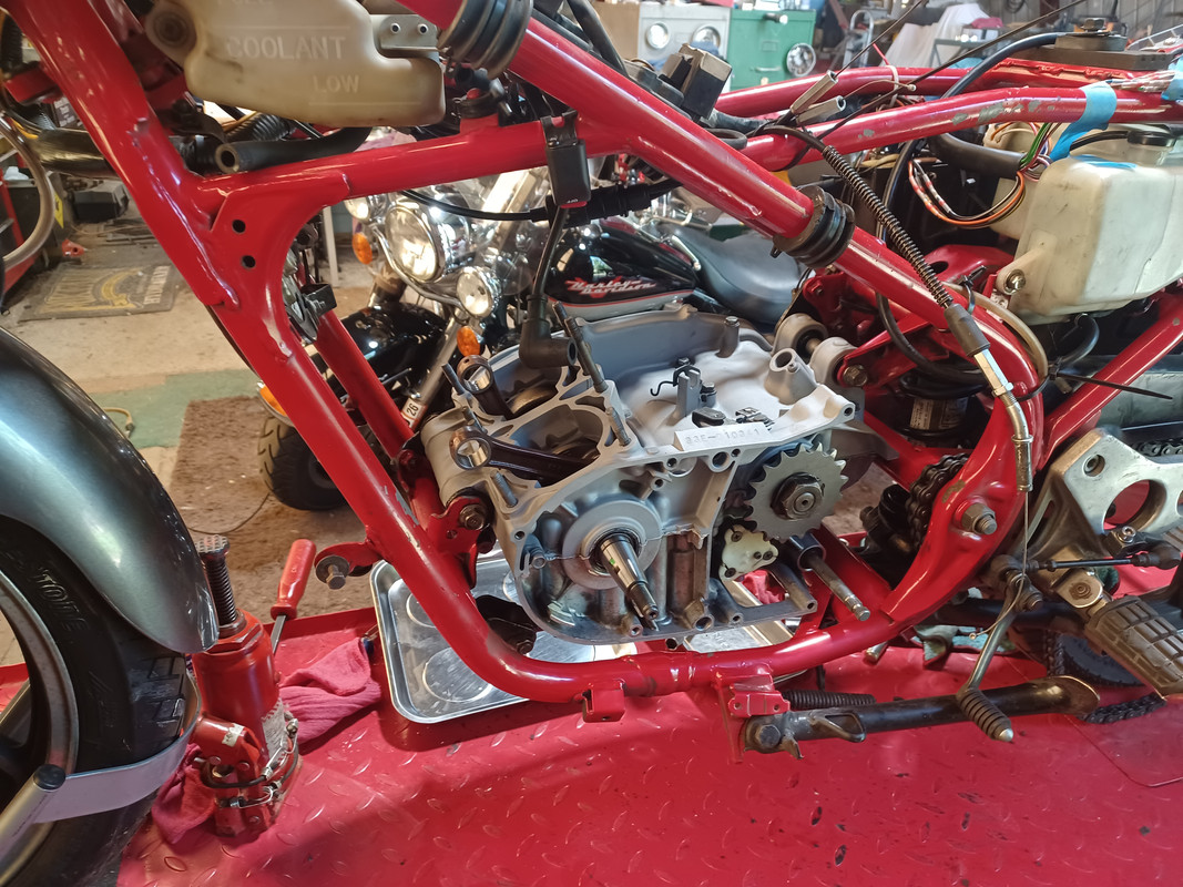

More progress.
Completely by accident going through my hoard I discovered 30MM stock Kawasaki H2 factory intake rubber clamps fit the Mikuni intake rubbers supplied with the Chariot intake.

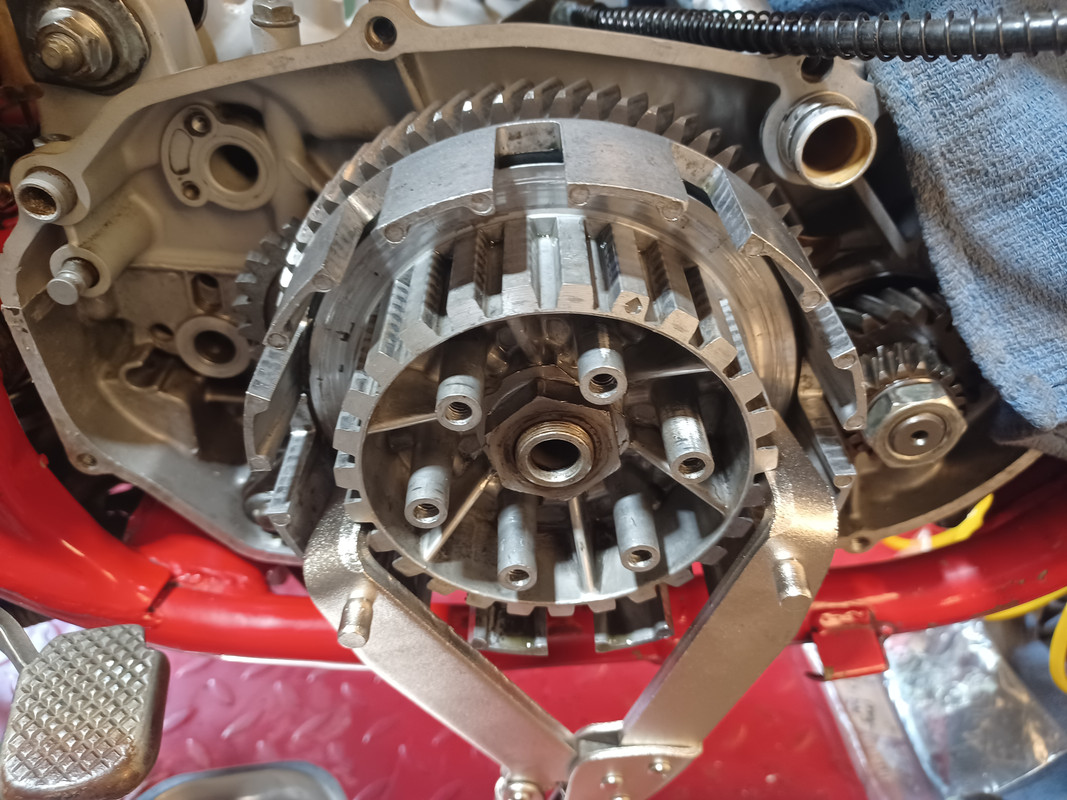

Clutch, kicker and counter-shaft gear reinstalled. . No adjustment was necessary.

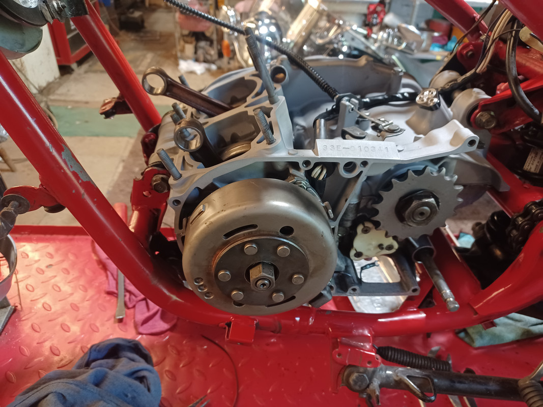

Stator and rotor reinstalled. The woodruff key engaged me in a battle of wills along with my bifocals but I emerged victorious.

I may have missed it, and I did look, but what crank are you using for this?
Looking forward to see it and hearing it next year.
I am using a plus 4 MM Hotrods crank that came in the kit from AZ Quad parts.
I am pleased to report the oil pump is visiting the UK and has arrived at Arrow's house for the rebuild and 421 upgrade.
