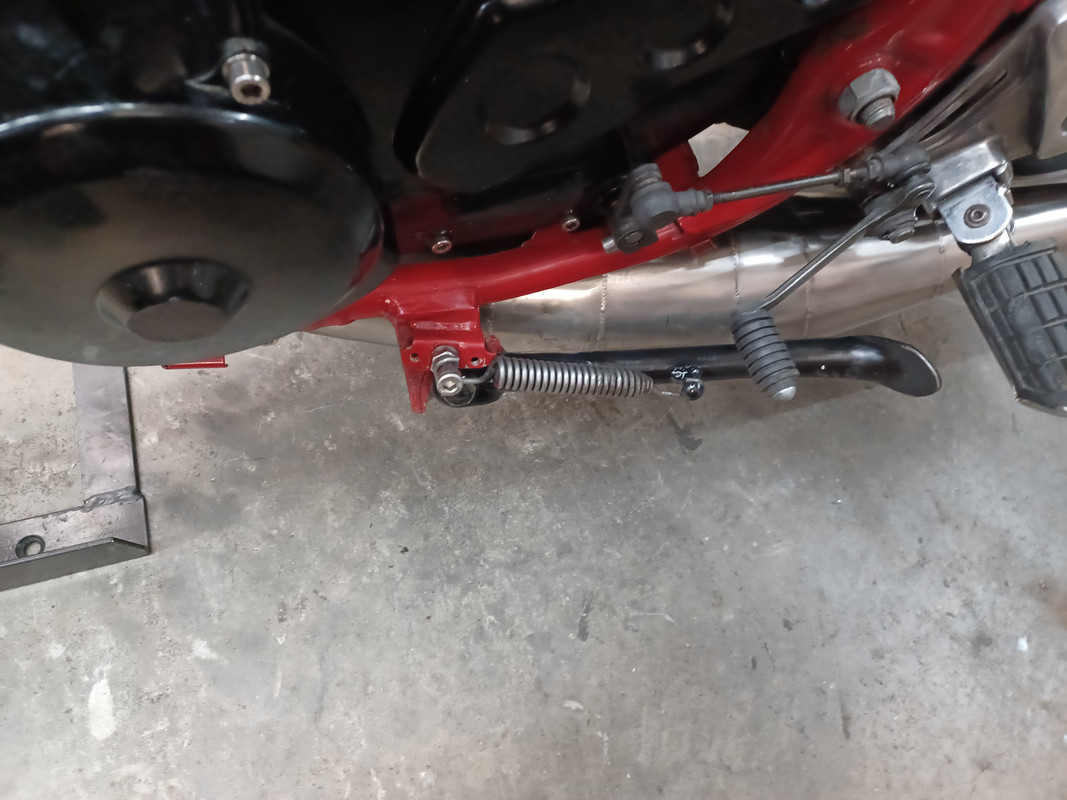

Mark did a beautiful job on the side stand mod.:patriot:
Clears like a champ now. And thanks to his wizardry with a dental burr the broken and stuck LH choke assembly is replaced with one from his parts stash. All told a little over 2 hours on the initial fire up, pipe spacing and side stand mod.

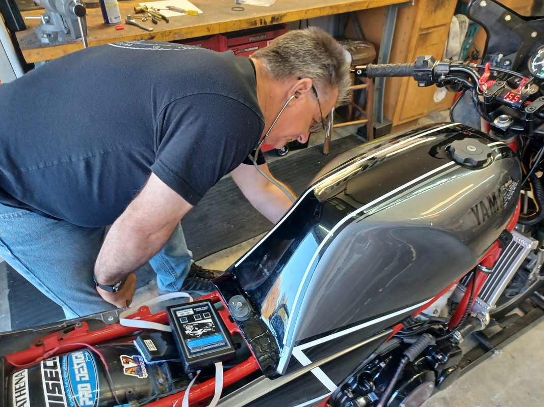

The Good Doctor Haase checking the pulse of the newborn... :thumbs:
#155

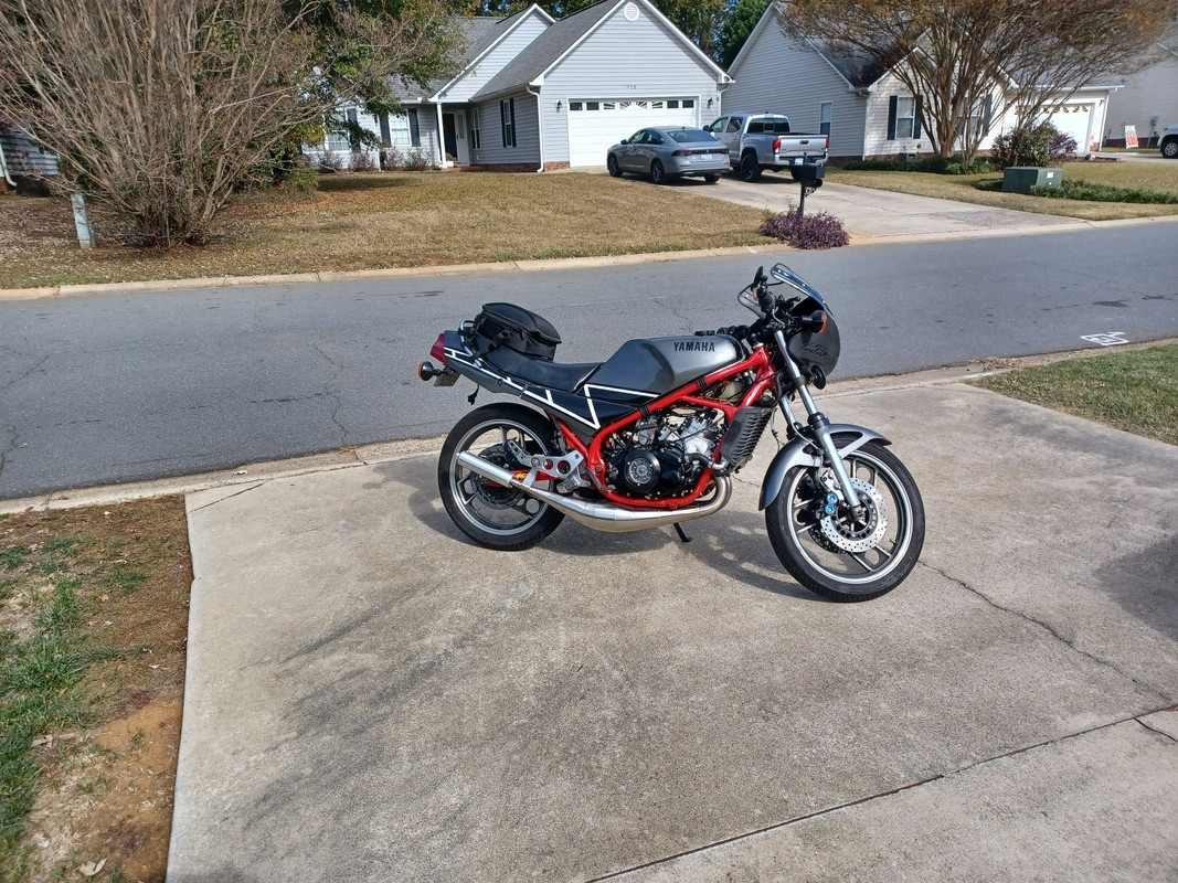

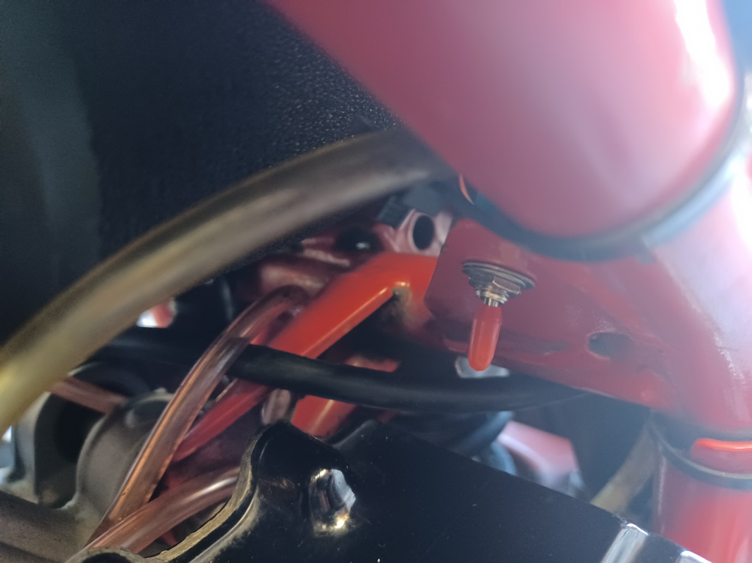

Mark worked his magic today and the Gray Ghost is sorted. A couple of minor changes to the Zeeltronic curve, one clip position change on the needles and  a couple of airscrew adjustments and the carburetion is linear. Mark drilled, counter-bored and tapped the slide stop screw on the RH carb to move the screw from inside to outside for easy idle adjustment.
The power delivery is smooth and once the tach hits 7000 you need to be hanging on. Power wheelies are at will in 1st through 3rd gear with 17-40 stock RZ gearing. Acceleration is brutal. 70 miles of flogging yielded 25 MPG. That being said it very rideable and pulls from idle in any gear. Thank you so much Mark!!
