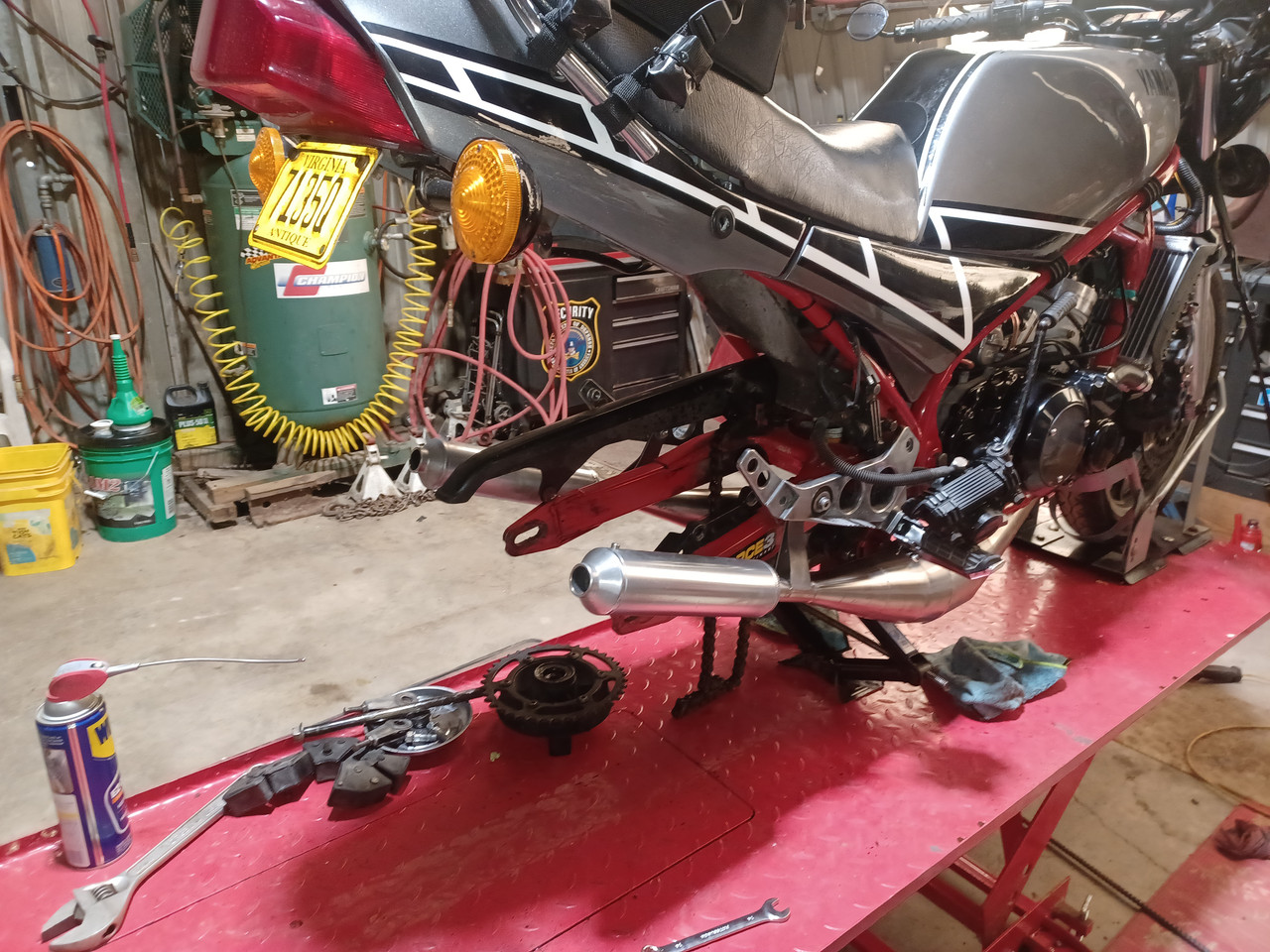

So, turns out the LCs use the same kicker shaft as RZs and banshees so I started looking for a LC Kick starter. Different bend to the RZ one, but that didnt really matter. Yambits sells a copy that looks way better than the ebay chines one, but I ended up finding a really good shape one close to home for decent money. Fits perfect and the bend clears the rear sets nicelyRD.jpg
