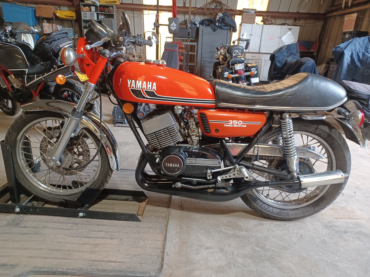

i drilled a 3.5mm hole thru at a 45 degree angle, then ran  an m4 screw thru. carbon steel, ground the head down to fit between the fins.
can sort of see it in the pic.
