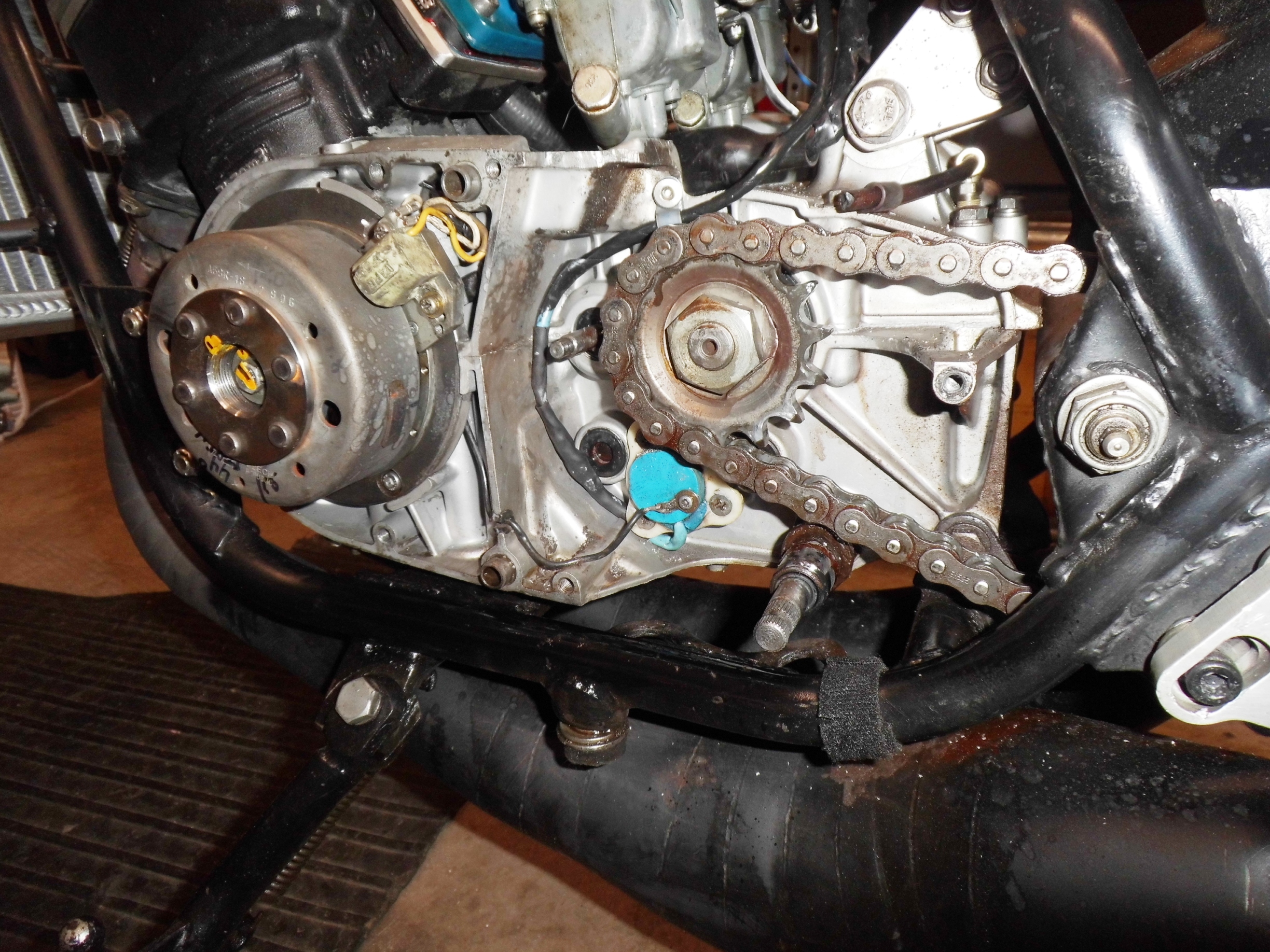

 Need to remove the left crank case cover to replace gear shift rod seal. Is there a gasket between the cover and the engine? Do  I need to remove the generator cover also? Any tips would be very helpful.
Any secrets to replacing the seal? I have broken a screw on the right side cover screw before . I bought a Soto Pocket Torch. figured I would try and heat each screw before removing.

 Yes, generator cover comes off. Just  remove shifter, then all screws (except the 2  M5 screws for the clutch adjuster cover. Then pull off generator cover, then the main cover. If you struggle with the JIS screws, replacing with allen head M6 screws is a good idea. Just do not over tighten them when assembling, I use a small torque wrench set to 10 Nm.
And the pinch screw on the shifter needs to be pulled out completely before pulling the shifter off.
