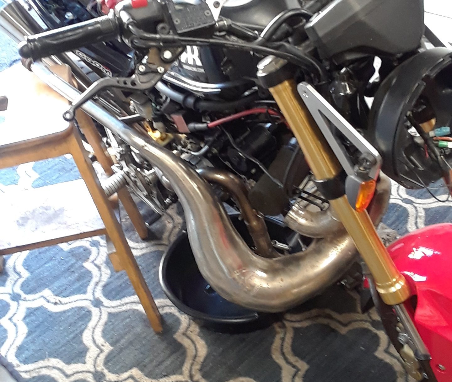

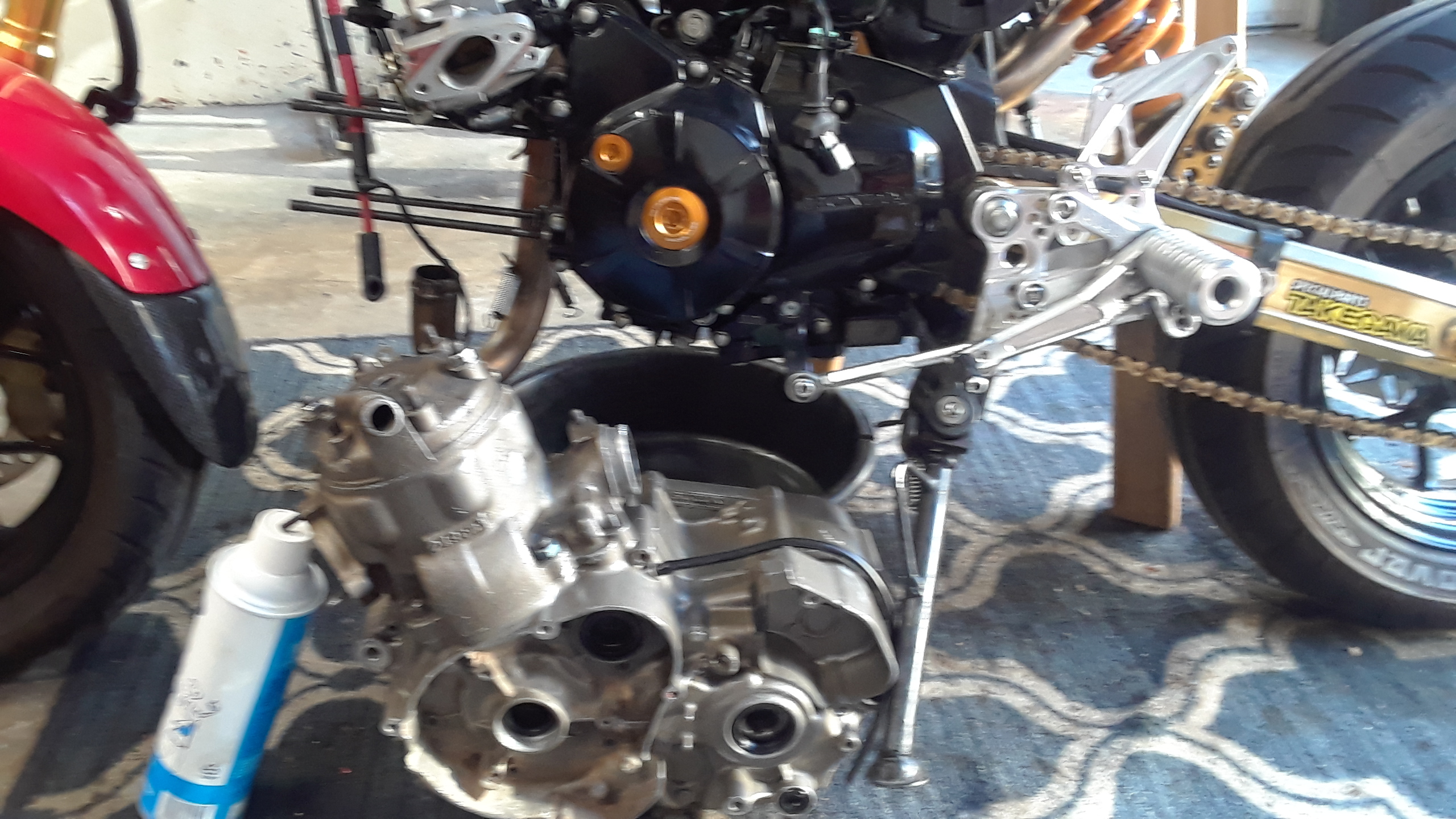

preliminary eyeballing seems to show that this should be pretty good to fit. to that point.. i think the rear motor mount may actually line up by absolute coincidence. or be extremely close. I still need to add an upper/front, remove the stock upper mount on the grom frame, and figure out how to clock the carb out a bit.
I also just sort of set the fmf pipe i have for the 250 motor in there, i should be able to run it with minimal mods, some re-clocking and the stinger will need to be reworked. (it should sit back about 4-6" from where it is in there now) when i get the original motor out in the next day or 2 this will make things a lot clearer.  :haw:
