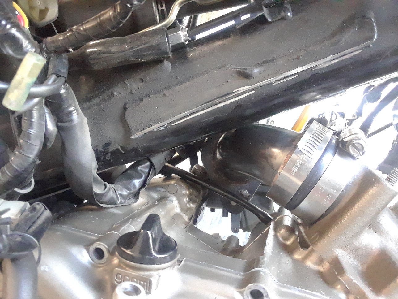

now that that was set, i needed to make sure the motor was set so i can get some form of an intake on there. balancing between the exhaust clearance issues that will crop up (by moving motor any further forward)  and screwing up the chain alignment (which was good here now) but dropping it any further, i had to make a concession. even moving the motor up to 2" in any direction, i would have had to go this way, si i just tightened up the clearance and made the intake. the downside is it adds a bend and 2.5" of runner length.   :bang:  Ive read various theories on this, and hopefully it will just move the power band down some. either way, i'll have to live with it. If i lose a hp or 3 im ok with that.  the upside is that the carb will be very easy to get to.
i mocked up up with a aVM35 as the flatslide for the motor isn't here yet. the exhaust is going up and over the other side of the motor.
Not ideal, but should be ok for a 220 lb bike.
clearance to the frame rail. the ID of the runner is 34mm, transitions are smoothed out and no steps.
^ the bend is a section out of a car header from a turbo'd civic. just had it laying around.  the round flange is stainless tube i had lathed down, and th eend plate is just 1/4" plate i hand cut. I am going to face that on the mill as the welding warped it a bot. all filler rod used was stainless.
