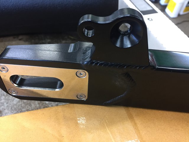

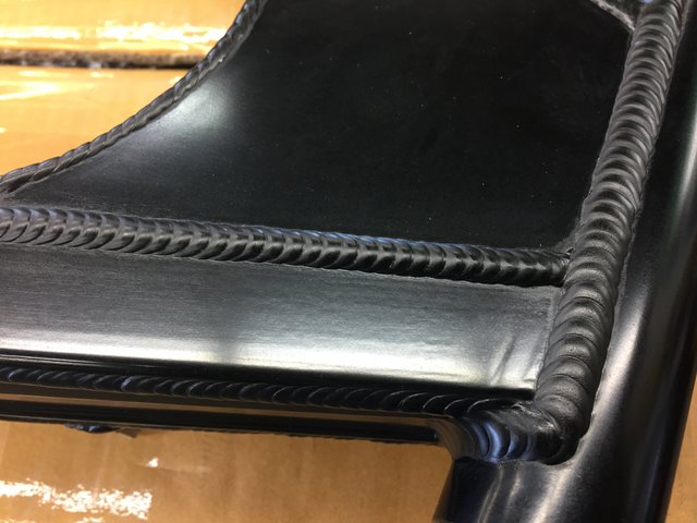

The one in the middle in the first of the above pictures is a Motolanna superlite alloy one made in Thailand. Not really for a RD but easy to adapt. Weight in at 2,95kg
Here installed in a 1976 RD250 race bike of a friend of mine
The black one in the first pic above is from Webike in Japan. Made by the same company who do the Motolanna ones. Alloy also. Weight in at 2,96kg.

Motolana for SR500:
Tell me it's not identical to Uwe's WeBike 'arm!

@85RZwade,
after purchasing my Webike and Motolanna swingarms last year I digged a bit deeper. I found out that a few more companies sell these swingarms. After browsing around in the end I dragged down the manufacturer of these arms. It is a small racing team(2 or 3 guys) who build them. Sadly I lost the records of them after a computer crash I had this summer. And even after searching around now I didn't find them anymore. They have a website.
Regards Uwe
81 Jackson 250,2x 74 RD250 racer,78 RD400 2R9,77 RD400 1A1,72 R5/RD350 rat,74 RD250 streettracker,75 Yapol TZ250,3x 76 TZ2/350,89 Honda RS125,
80 Hejira PE250,77 Höpfner-TD3,76 RD/TD3,75 TZ/RD250A,78 Siroko TZ250,86 Tomic 200,91 TDR250,86 TZR250,2x 94 FZ750,86 FZ750/1000,99 TDM850
Now I can tell people that my swingarm came out of a small Thai race shop! They do beautiful work; I hope it pays for their racing.
