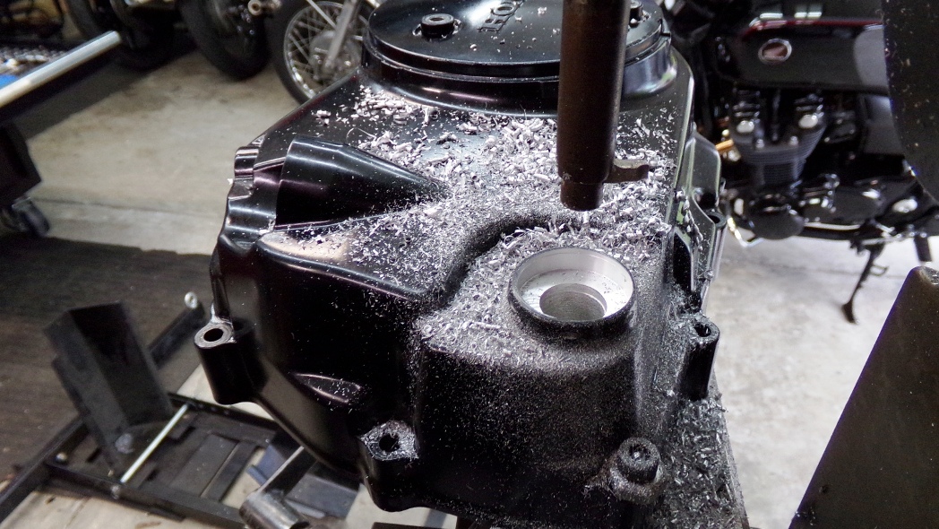

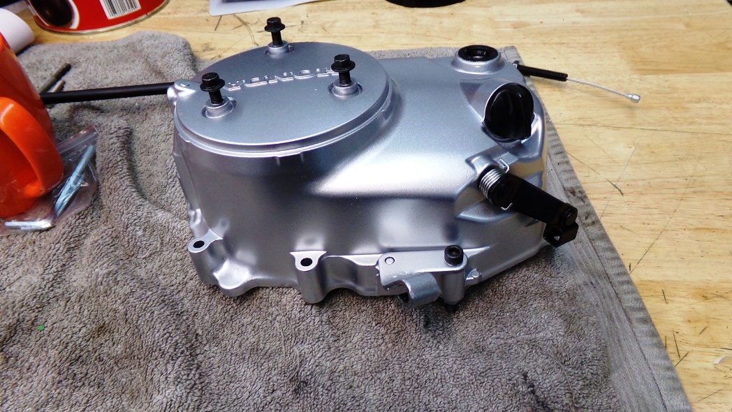

I had to order  a'racing' part from thailand to get the primary gear engaged sleeve, took over 6 weeks, which then fucked up the oiling int he crank, and i had to bypass the slinger holes, and machine a sleeve to direct it or it would starve the top end. 9cranks are different from the trail to the grom, for example).  also, the clutch stack is shorter, so I had to use a trail clutch, but stack out the bearing int eh pressure polate to make the stock grom cover work, which, i also had to machine to accept the kickstarter.
I used a factory grom clutch perch, lever, cover, pusher, etc. aftermarket pressure plate and steels.

sleeve i lathed up. this was a press fit deep into the end of the crank (rh side of pic) after i drilled out the blocked portion between the 2 sections w the oil ports. the oil goes thrut he crank, then into the bearing int eh side cover, and channels up to the top end in a really convoluted way.
grom clutch stack rh side, trail to left. I used the billet pressur eplate and the discs off the grom one. the stack is too tall to clear the spinner on the trail, so had to go shorter.
fyi, the cover and some of the clutch parts were leftovers i had from the '14 grom.
as installed. but like said, bracket was re-bent and welded and now sits behind the bodywork, much cleaner.
