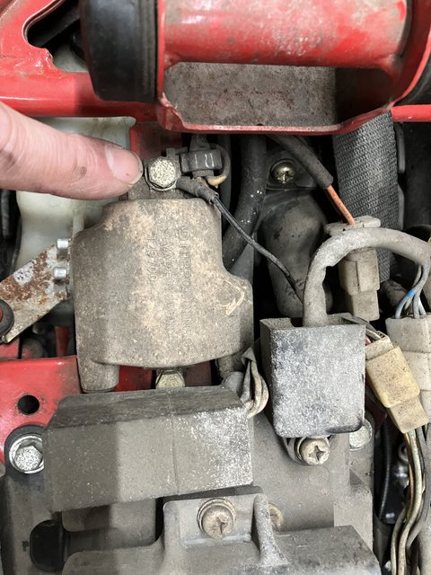

Hit a snag, turning on the ignition gives NO indication of any current whatsoever (no servo motor click, horn, blinkers, etc.). I also did charge the battery using trickle charger. I see two wires that I seem to not have any idea:-
1. Audio Pilot Assembly (part # 48H-83390-20-00) - This is ONLY required for stock exhaust with CAT, I saw Ken's videos and look like he skipped them too. Reference minute mark 3:30 - https://www.youtube.com/watch?v=QGdgqExZpQ0
Am I getting it right?
2. This black terminal ring coming from the main harness doesn't seem to makes sense on where goes. Can someone help, please?

Check your fuse box connections. If you still have the factory original fuse box, they are notorious for flaking out. In that case, wire in a new repop one or convert to a blade type box.

Make damn sure that ring lug for ground has an excellent connection.
And what Evans said. All of mine (except the original 83) get this treatment
TeeZee
Thanks 85RZwade, Ken and Evans! Appreciate all the responses.
I tried what Ken has shown for ground connection. Charged the battery to it's fullest and checked on fuses. Still the same.  :bang:
So, next thing I'm gonna do is follow Evans idea and ordered a Hella Fuse box with 6 circuit capacity (#H84960091). The more impatient I get ..... the more elusive it is.
Before you modify more circuits, go back to basics.  Check the connector to the key switch and see if you have power to the switch and then see if you have power coming out of the switch to the various circuits.  And check the connectors at that huge assed battery stuffed in there.

Okay, so few more updates from the weekend - Once again my good friend Brian came to the rescue.
Electrical issue fixed (well sorta). The culprit was the main connector that goes to ignition, it had 2 wires (Red-main & brown-ground?) cut up by previous owner. Once fixed, it does the YPVS valve check, lights, signals work. Still have elusive neutral light, rear brake light and horn to chase on.
