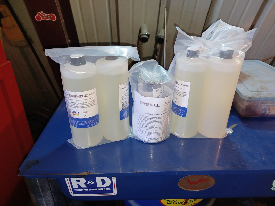

The big brown goody truck came today and the prep began.

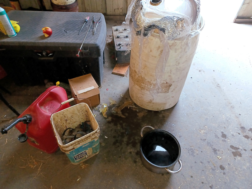

3 coats of seal mask paint protector applied with a paint brush. Tomorrow I will wrap the tank in glad wrap and tin foil per the instructions and pour in a gallon of stripper. I made a template from a junk petcock and cut a piece of inner tube to block the petcock hole using the junk petcock.

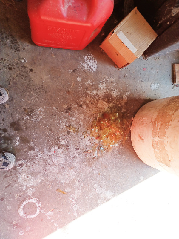

It is a slow process so far. I spent the day agitating it by hand.  It says it can take as long as over night. We will see.

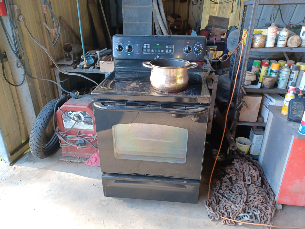

After two days of agitating and not much progress I boiled a big pot of water x2 on my shop stove and poured it into the tank. Finally some progress. I spent the afternoon grabbing what I could reach with the long needle noses and dragging it out of the filler hole.
Tomorrow's plan is to drain the stripper water mix into a bucket and hope all the liner comes out.
If it doesn't I will boil the mixture and try again.

Another pile of liner. I used mechanical fingers to grab the sheets and chunks along with the long needle noses to twist it into a knot and drag it out through the fill hole. I boiled the solution 3 times today and got nearly all of it out. I left the mixture in overnight. I hope to be done with the stripping tomorrow.
My $25 FB Marketplace shop stove comes through again. I am so glad I put casters on it so I can roll it around easily. I moved it right next to the doors so the fumes from the boiling stripper don't kill me.
